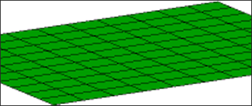

- Default Shell Thickness (No Selection)
- HyperMesh represents composite layers, when
visible, as 2D shells:

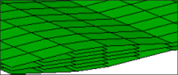

Figure 2. Layers Off (No Selection)

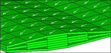

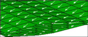

Figure 3. Ply Layers
Figure 4. Ply Layers with Direction

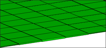

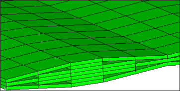

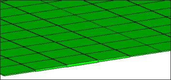

- 3D Shell Thickness
Figure 5. Layers Off (No Selection)

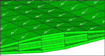

Figure 6. Ply Layers
Figure 7. Ply Layers with Direction

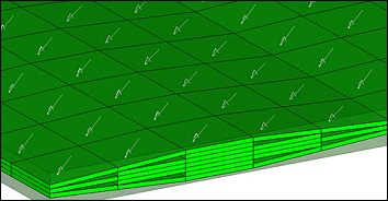

Figure 9. Ply Layers
Figure 10. Ply Layers with Direction

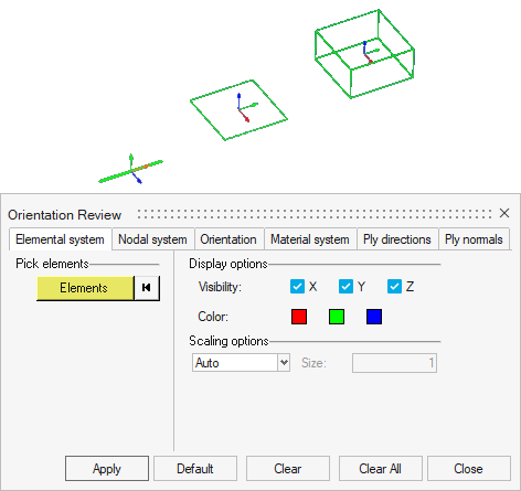

From the Elements ribbon, click the Orientation Review tool.
Figure 14.
- From the Orientation Review dialog, click the Elemental system tab.
- Use the Elements selector to select elements.
- Define the display options.
Select one of the following:
- Apply - Show the system display
- Clear - Clear the plot generated by this tab
- Clear All - Clear all plots generated by Orientation Review

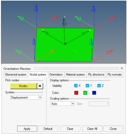

Nodal System
Plot systems associated with nodes.
Typically used to review displacement and reference systems in the OptiStruct and Nastran user profiles.
| Option | Action |
| Pick Nodes | Select nodes on which to display system information. |
| System | Determines system type to plot. Specific to OptiStruct and Nastran displacement and reference
systems on GRID card. Choose from:
Nodal System Usage
How to use the Nodal System tab.
Figure 16.
- From the Orientation Review dialog, click the Nodal system tab.
- Use the Nodes selector to select nodes.
- Set System to Displacement.
- Apply - Display the displacement system assigned to each selected node
Figure 17.

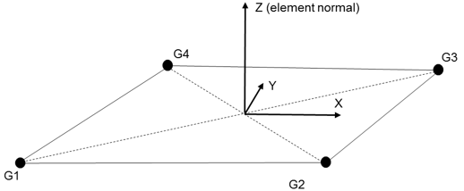

Element orientations for most solvers are determined by the sequence of nodes on the element card. This tab provides several methods of node renumbering to change element coordinate system x or z axis.

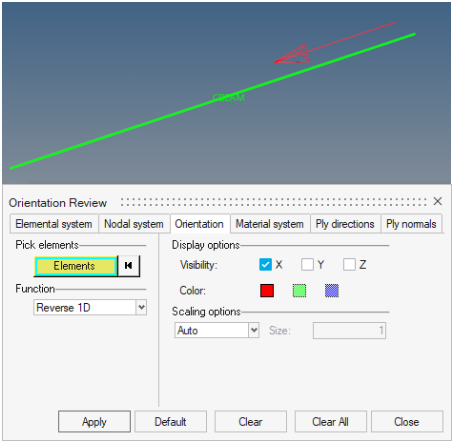

Orientation Usage – Reverse 1D
How to use the Orientation tab.
Figure 18.
- From the Orientation Review dialog, click the Orientation tab.
- Set Function to Reverse 1D.
- Apply - Reverse selected 1D element directions
Figure 19.

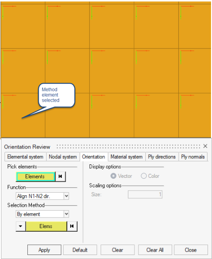

Orientation Usage - Align N1-N2 Direction
Figure 20.
- Set Function to Align N1-N2 dir.
- Set Selection Method to By element and select an element to use as a template for elements selected in Step 2.
- Define display options.
- Apply - Align N1-N2 directions
Figure 21.

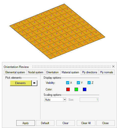

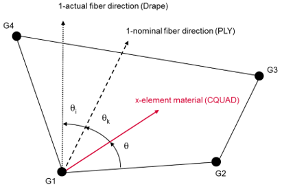

Material System
Plot the material coordinate system on elements.
| Option | Action |
| Pick Elements | Select elements on which to plot x, y and/or z material system directions. |
Material System Usage
How to use the Material System tab.
Figure 23.
- From the Orientation Review dialog, click the Material system tab.
Figure 24.

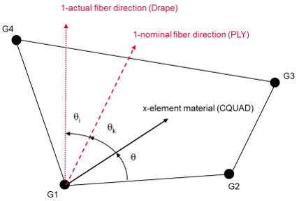

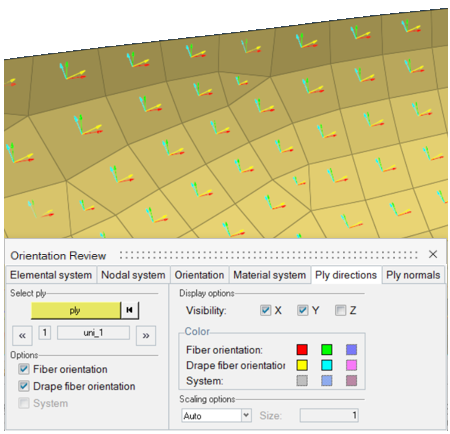

Ply Directions
Plot the 1, 2 and/or 3 directions of plies.
| Option | Action |
| Select ply | Select a ply to plot orientation by clicking the yellow ply collector. Alternatively, use the arrows to move through the list of plies in the model. |
| Options | Choose which ply directions to plot:
Ply Directions Usage
How to use the Ply Directions tab.
Figure 26.
- From the Orientation Review dialog, click the Ply directions tab.
- Use the plies selector to select a ply or use the arrows to toggle through plies.
- Confirm that Fiber Orientation is selected. Optionally, select Drape fiber orientation if your model has drape tables.
- Apply - Show the ply
directions for the selected ply
Use the arrows in the ply selection to toggle through plies in the model.
Figure 27.

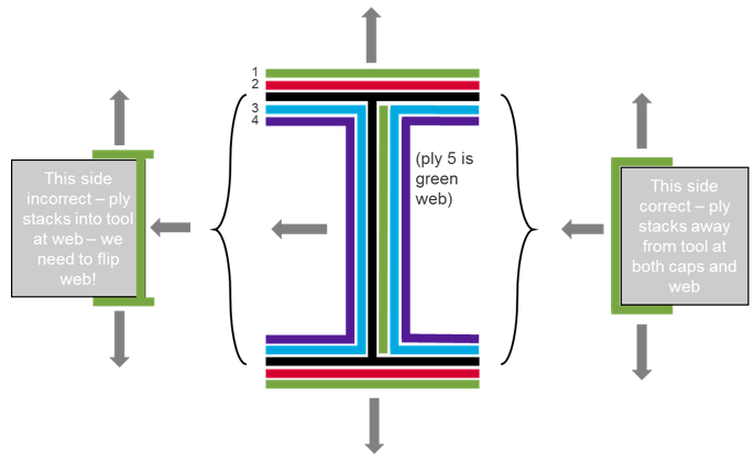

Ply Normals
Plot and correct the ply normal of plies.
The discontinuity in stacking direction on the left side of the I-beam model will be corrected using ply normals. Ply normals manipulate the direction an individual ply stacks. When the ply normal tool is used to reverse a ply normal, a drape table is created for the ply. It subtracts 2*θ from the ply orientation which is mathematically equivalent to flipping the direction the ply is stacked.
| Option | Action |
| Normals | Choose from:
| Pick elements | Typically only a portion of a given ply requires that ply normals are flipped. This selection determines which elements of a ply will be flipped. |
Ply Normals Usage
How to use the Ply Normals tab.
Figure 29.
- From the Orientation Review dialog, click the Ply normals tab.
- Click Apply to plot the current ply normals.
Toggle the Select ply arrows until a ply is reached that
requires normals to be flipped.
Notice the discontinuity.
- To correct ply normals, click the Pick elements collector twice to access the element selection panel and select only those elements that need to be flipped.
Select the Reverse radio button under Normals and click
Apply.
This will flip the stacking direction for just the elements of the ply at the selected elements.
Select the Display radio button under Normals and click
Apply.
This will plot corrected ply normals for the ply.
