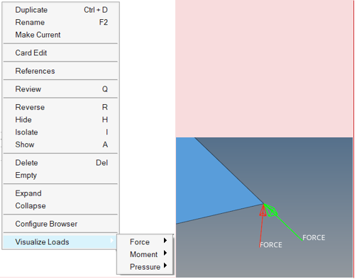

Realization
A realization command is provided for those who choose to work with classic loads. The "realizefieldloads" command creates classic loads from engineering loads, although it is not the exact reversal of the absorption command.

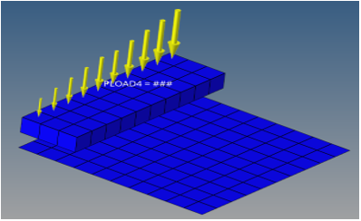

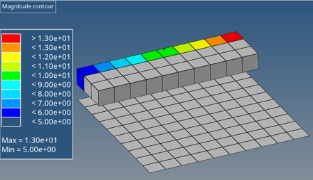

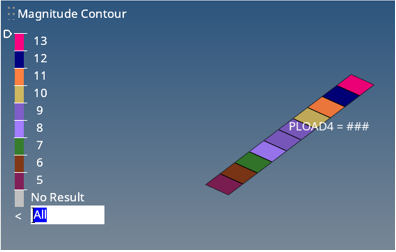

Load Visualization
- Vector Plots – display value distribution with the direction of the load
- Advanced Contour Plots – display value distribution with interactive filters
- Contour Plots – display value distribution with respect to the entire model
Figure 3.
Load values can be plotted at specific time stamps for curve-based time dependent loads.
