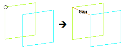

Create Gap Elements
Use the Gaps tool to create 0D/1D gap elements.
From the 1D ribbon, select the Gaps
0D or Gaps 1D tool.
Define the element.
Option Action Type Select an element type. Linear 1D Create one-dimensional elements based on a projection of Elems A to Elems B. Elems A Select the elements where you want the elements to begin. Restriction: Only available when the Linear 1D check box is selected.Elems B Select the elements where you want the elements to end. Restriction: Only available when the Linear 1D check box is selected.Node A Select the element's starting node. Note: Node A is required for 0D elements.Node B Select the element's ending node. Density A-B Specify the number of gap elements you want created between each of the selected elements. Restriction: Only available when the Linear 1D check box is selected.Orientation Type Choose between methods of orienting the element. Orientation is only necessary when the nodes are coincident. - Default
- Do not use an orientation. If necessary, use the global coordinate system.
- Direction
- Select three points to define a plane whose normal serves as the vector using the N1, N2, and N3 selectors.
- Node
- Specify a node, the vector from the coincident nodes to this one is the orientation vector.
- System
- Orient the element based on a selected local system coordinate.
Property Select a property to assign to new and existing gap elements. - Click Create.
