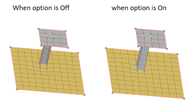

- Do not remesh/rebuild extension
- Use to avoid remesh or rebuild of the patch elements.
Figure 6.

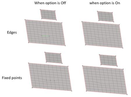

- Do not add fixed points/edges on nodes imprint
- Use to imprint nodes on FE geometry without fixed points or edges.
Figure 8.
