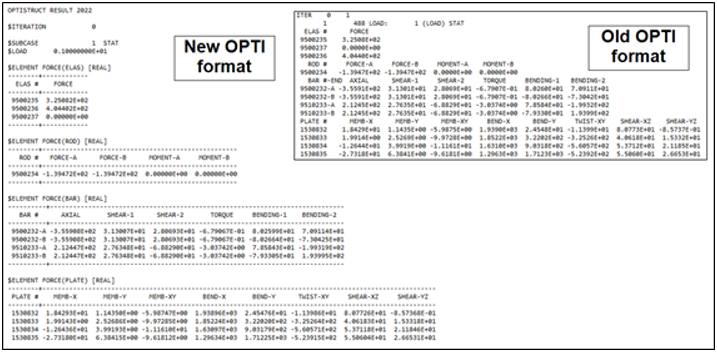

The figure below compares the old and new OPTI formats using ELFORCE (.force) as an example, which has improved readability.
