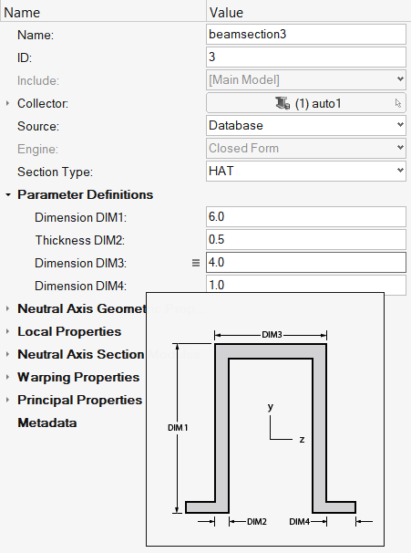

Create Standard Sections
Standard sections are predefined shapes from a database with dimensions like Channel, Hat, I, or L sections. Most of them are directly available in the solver. Section properties are evaluated using a closed form solution.
Set the Source to Database.
Engine will automatically set to Closed Form.
- Change the section type to the desired shape.
Define the beam section parameters.
Listed dimensions are based on the selected shape.
Hover your mouse over an option to view a diagram.

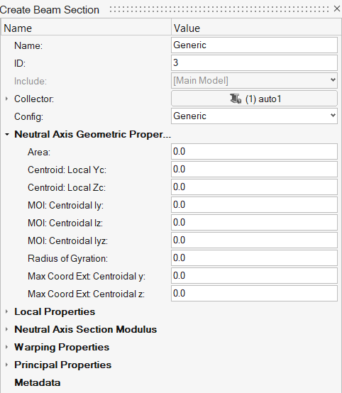

Create Generic Sections
Generic sections define sections without defining actual cross-section geometry.
- Set the Source to Generic.
- Enter desired geometric properties such as Area or Iyy/Izz.
For warping properties, provide:
- Shear center location Ys/Zs
- Torsional constant J
- Warping constant
The Y axis (resp Z) values define values in the beam elemental system. The origin of the local system can be defined anywhere; in this case, properly enter the coordinates of the section’s Centroid Yc/Zc.
The values mapped to the property are the components of the Centroid from Shear center, independent of the local origin used in the beamsection.
Figure 3.

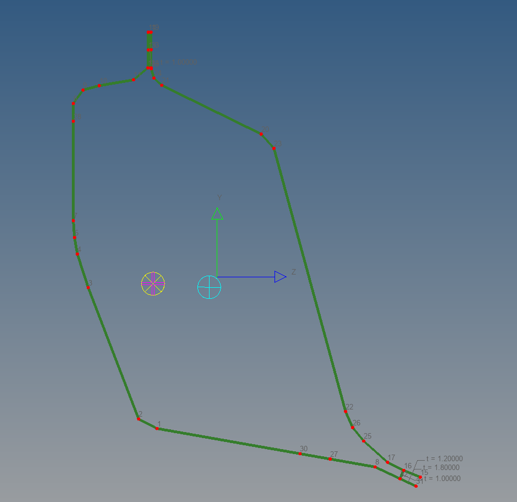

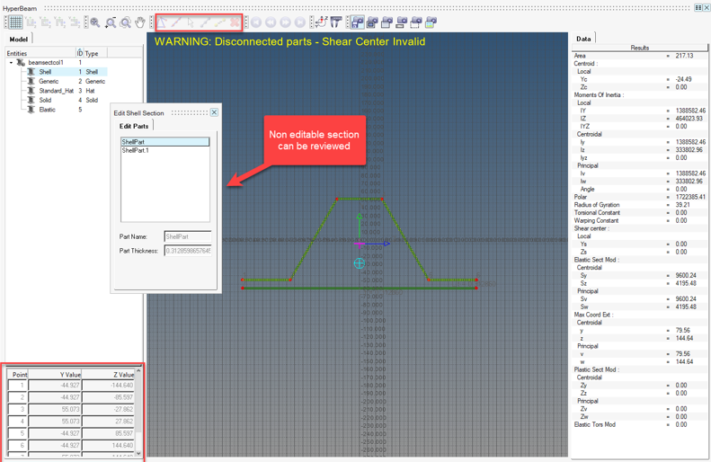

You can still review the realized beam section in HyperBeam. Sections can be reviewed but not edited.
To further edit beam sections in legacy tools, reset the sketch entity assigned to the beam section. This keeps the realized data but removes the dependency to the sketch.

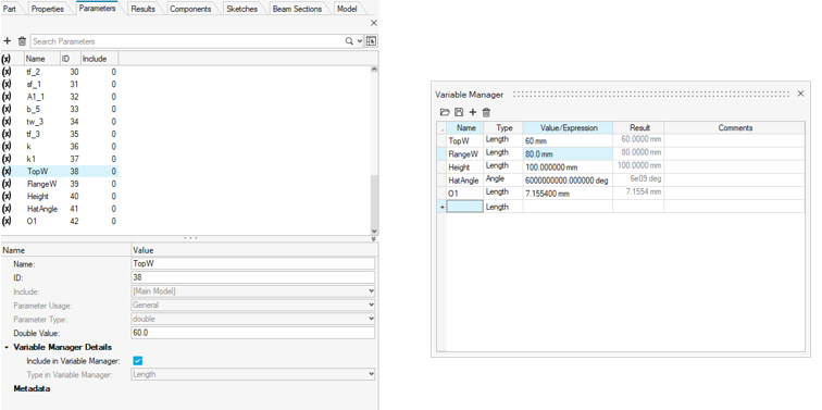

If the sketch has variable assigned to it (parametrized):
- From the Sketch ribbon, click the Variable Manager tool and update variable values.
- Or, use the Parameter Browser and update parameters.
- Beam sections are updated each time a variable is changed.
Figure 6.

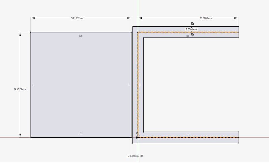

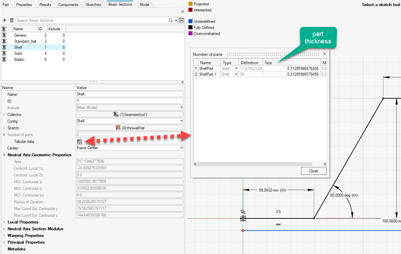

To update part thickness:
- If a single part is found, the Entity Editor directly displays the Size. Change this value to updatethe part thickness.
- If more than one part is found, click the Tabular Data icon in the Entity Editor and update part thickness.

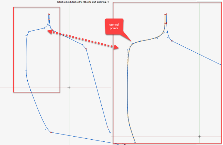

Absorb Sketches
- Select one or more beam sections in the beam section browser.
Right-click and select Absorb Sketch.
This option is only available if at least one of the selected beam sections is Shell or Solid. If a beam section already has a sketch assigned the nit is kept. Only orphan beam sections are absorbed.
Figure 7. Sketch absorbed from shell section
- Limitations
- The parts are regenerated from the created sketch lines.
- Smooth splines are created from original vertices. The shape may
deviate from the original lines.
- Original vertices are control points.
- Absorbed welds need to be extended to the spline location.
- The new data structure does not have the same limitation as the
legacy Shell part structure (no part can span across T junction
in legacy); hence, the number of parts may differ after absorb.
- You hence lose the original part distribution as well as name/thickness.

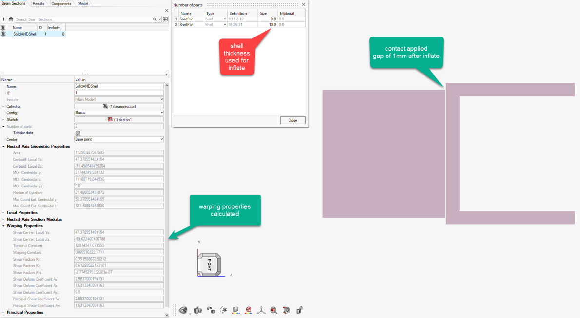

Hybrid Sketch and Contact
The following example (Figure 9 & Figure 12) depicts a hybrid sketch where 4 lines form a closed loop and 3 lines an open section. In this example, the Gap parameter is introduced to control distance between 2 shapes.
The closed loop is understood as a Solid part while the open section is considered a Shell part.

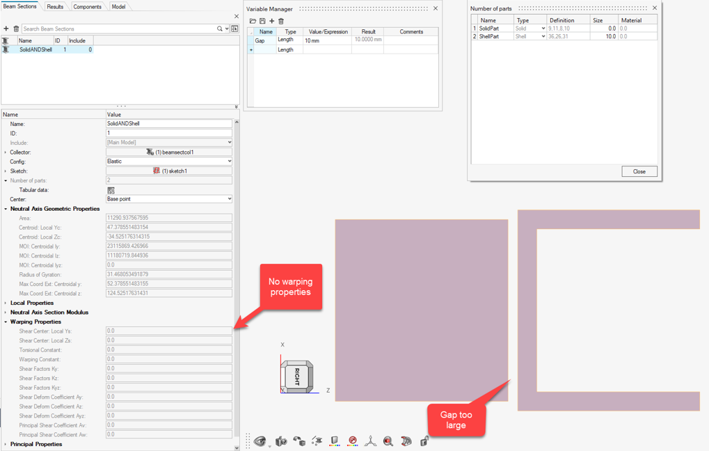

- In the first case the final gap after inflate is 1.0, which falls under the tolerance; hence, a contact is created between parts. Warping properties are evaluated.
- In the second case the final gap is 5.0, which is too large for this model; hence, no warping properties are available.

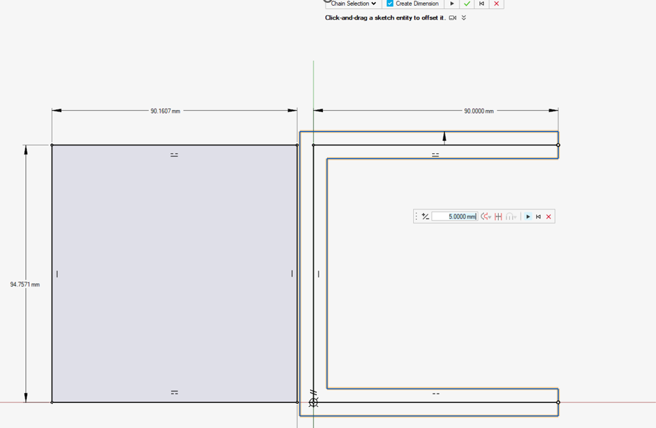

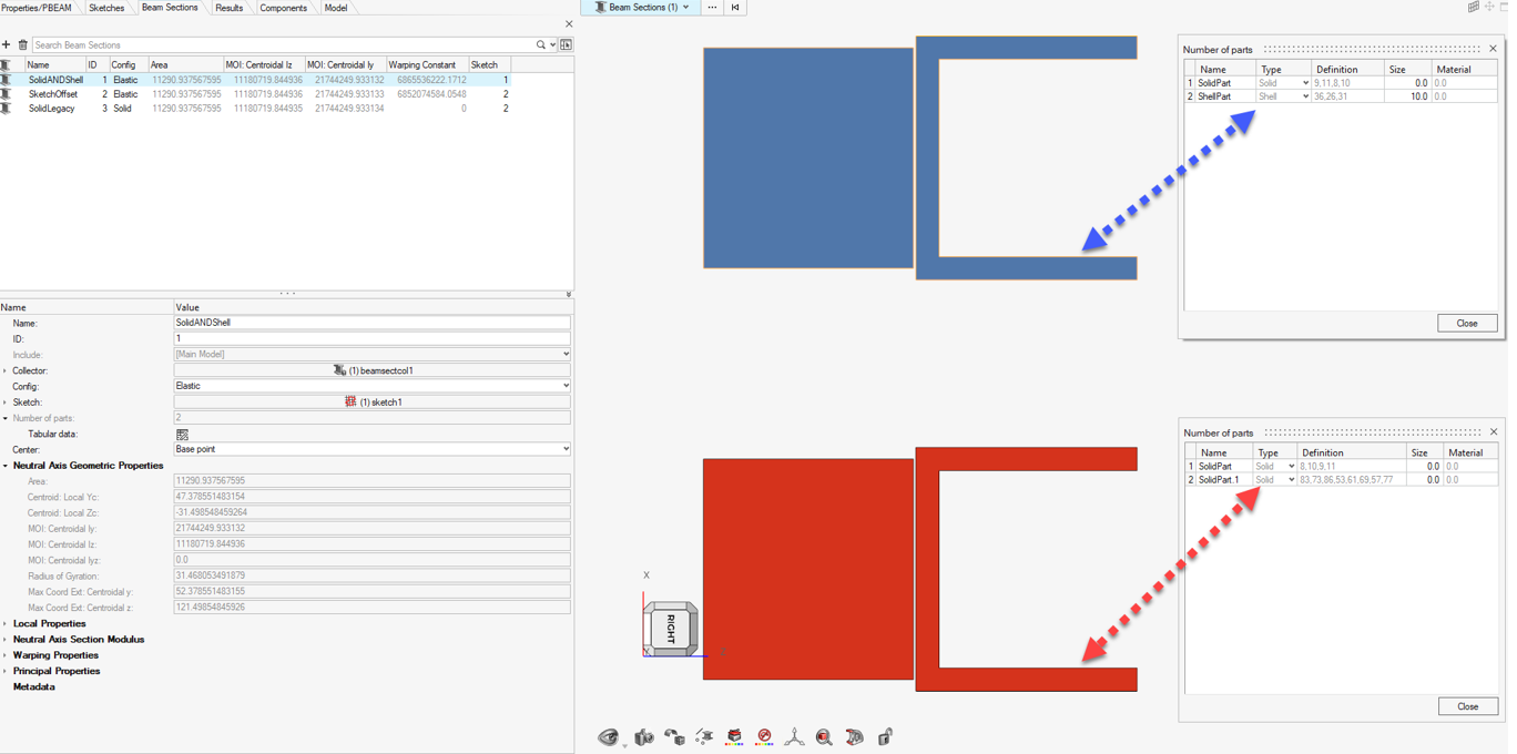

Solid Sketch
Using the same original sketch, you can use the Sketch Offset tool to create a symmetric offset of the open section to turn it into a closed loop of lines. Click and drag the offset to play with the solid section's thickness or enter a precise value (Figure 12).
- the top beam has a property referring to a hybrid sketch with a shell part of thickness 10.0.
- the bottom beam has a property referring to the offset sketch from Figure 12.
Contact management is the same in both cases (hybrid or full solid).
