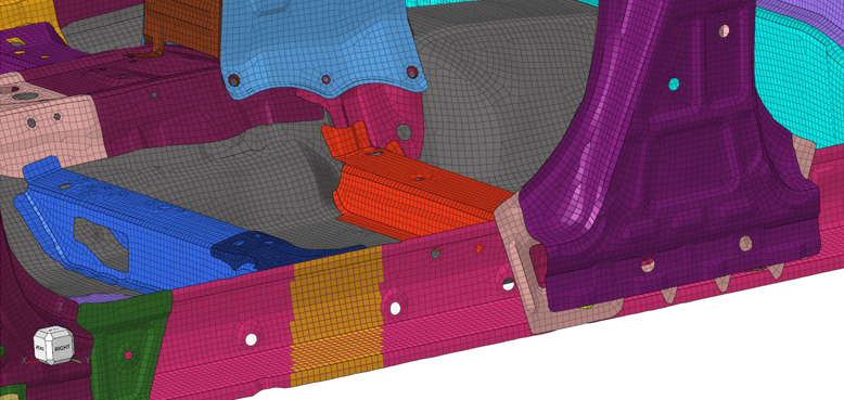

With the Element selector active on the guide bar,
select the elements where the bulkhead needs to be roughly located.
Figure 3.

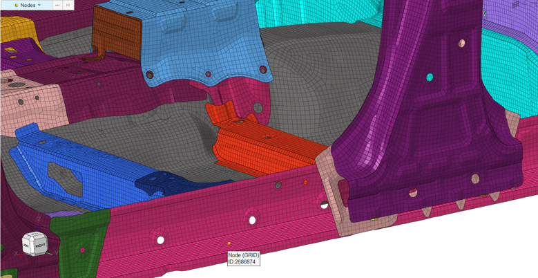

Click Base on the guide bar then
select the base node.

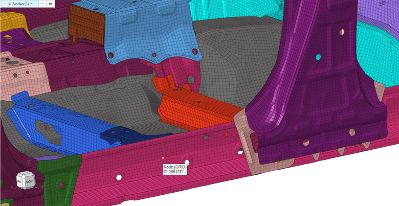

Note: The base node must be on the longest face of the selected elements. Figure 4 shows correct “Base” node selection. Figure 5 shows incorrect “Base” node selection that will not create a bulkhead.
Figure 4. Correct "Base" Node Selection (From the Longest Face)
Figure 5. Incorrect "Base" Node Selection

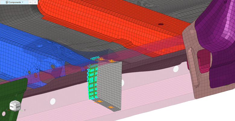

The bulkhead is created within a new component. The appropriate property card image (for example, PSHELL for the OptiStruct solver profile) is also created.Figure 6. Bulkhead Creation Completed
To complete the process, use connectors to attach the bulkhead to the surrounding part(s).Figure 7. Bulkhead With Connectors
