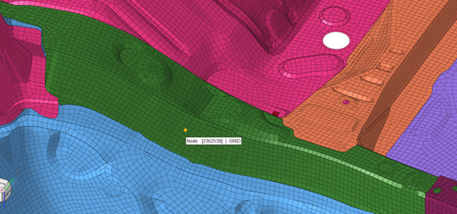

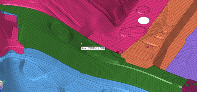

Click Base on the guide bar then
select the base node.
Note: The base node must be on the longest face of the selected elements. Figure 4 shows correct “Base” node selection. Figure 5 shows incorrect “Base” node selection that will not create a bulkhead.
Figure 4. Correct "Base" Node Selection (From the Longest Face)
Figure 5. Incorrect "Base" Node Selection

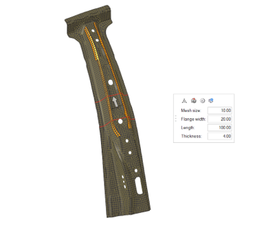

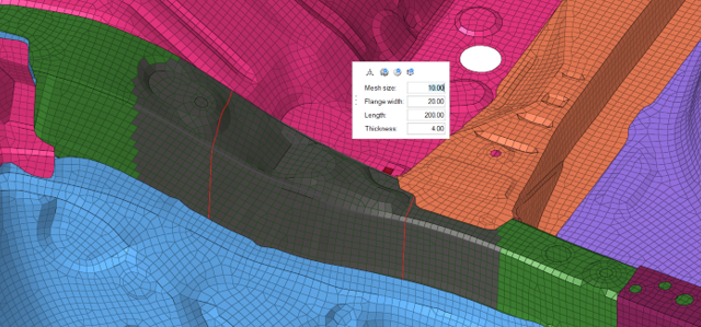

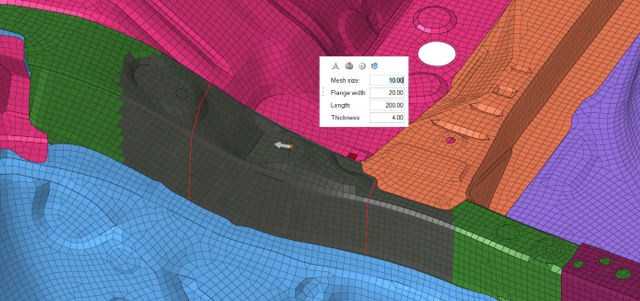

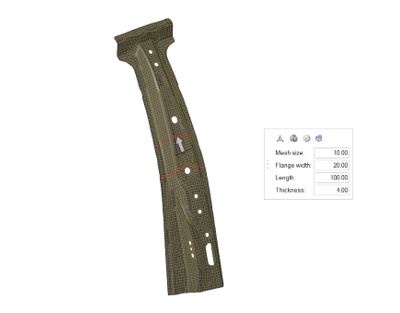

- Use the microdialog to edit the thickness of the doubler, the flange width, the length, and the mesh size.
- Optional:
Use the other icons in the microdialog to further
define the doubler.

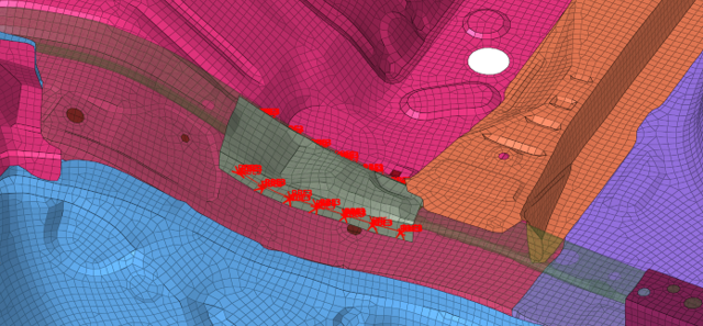

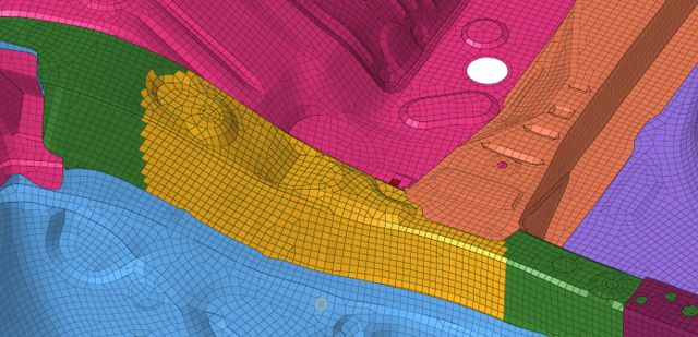

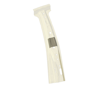

The doubler is created within a new component. The appropriate property card image (for example, PSHELL for the OptiStruct solver profile) is also created.Figure 7. Doubler Preview
Figure 8. Doubler Parameters With Material and Connection Control Selection
Figure 9. Doubler With Connectors

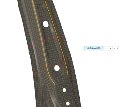

Click
to enter the edge selection mode.

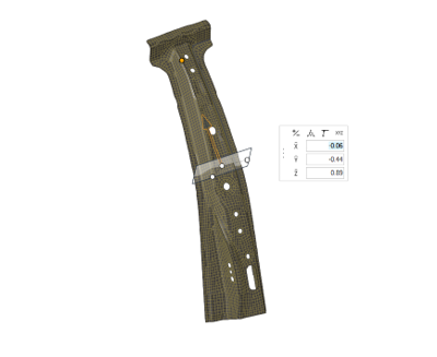

- Deselect existing edges using Shift+ left mouse selection window.
- Set the edge selection angle to 10◦ using Shift + mouse scroll.
Select two edges to differentiate between the doubler face and flanges (Figure 13).
Figure 13. Selection of Edges

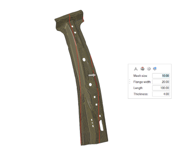

Figure 14. Doubler Preview with Correct Orientation and Edges
Click
on the guide bar.
Figure 15. Doubler After Edge Selection
