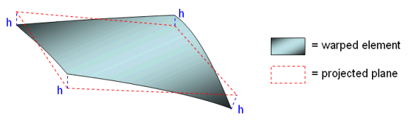

- Warping Factor
- Only applicable to quadrilateral elements as well as the quadrilateral faces of 3D bricks, wedges, and pyramids.
