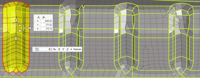

In the microdialog, toggle the Keep
original button.
- When on, the original elements are kept. Use the text box to select the number of instances of the feature to replicate. This is supported both for mesh associated to geometry as well as mesh not associated to geometry.

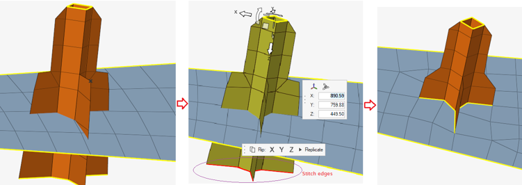

- This function comes in handy when extending or trimming the feature to
the base mesh. Refer to the example images below from left to right for
an illustration of the usage.Note: In this case, the copy option is turned off in order to trim the base mesh with the feature and create conformal feature edges on the base (as shown in the right most image).

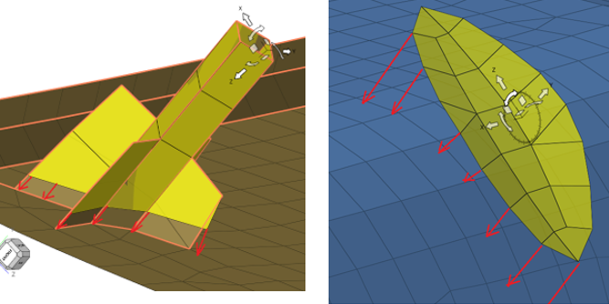

- Morph
- This option is best suited when there is a slight mismatch in the size and shape of the source and base feature; both features are morphed in order to create conformality.
- None
- If you would like to maintain the source topology unchanged, it is recommended to use this mapping method. In the following example, the left bead has been used as a source topology.
