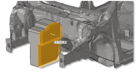

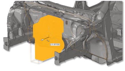

Position primitives to accommodate instant package space layout changes using
the Move tool
with the Collision detection option enabled.
If the Move tool encounters a physical clash while positioning a part and/or subsystem, the conflicting part will highlight.
Edit primitives using the Drag tool.
