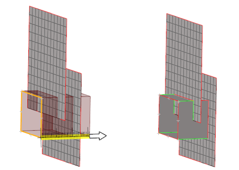

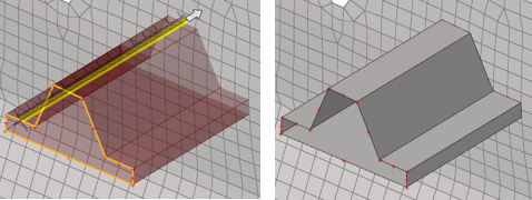

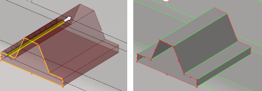

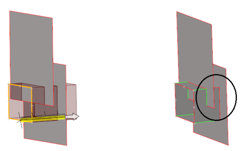

Auto-Trim
Use the auto-trim
option in the microdialog when extruding nodes and lines.
While extruding lines or nodes, if a continuous surface or mesh is intersected and this option is ON, the newly created surfaces are trimmed at the intersection. The auto-trim option works for both geometry intersecting geometry and mesh. It also works for FE topology intersecting FE topology.

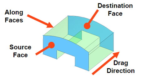

- Two opposing faces are called "Source" and "Target" faces.
- One or more faces that directly connect and enclose the volume between the source and target are called "Guide" faces.
- The drag direction is the vector from the source face to the destination face.

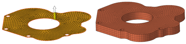

Create hex mesh in one of the following ways:

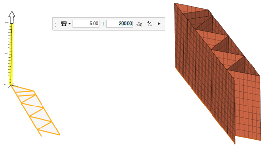

Option Description Along vector - In the microdialog, set a density value or an element size if not already defined in the options menu.
- Enter a thickness value or drag the manipulator to create hex
mesh along the element normal.
The biasing style works in conjunction with biasing intensity. If the intensity is "0", biasing is not applied.
Figure 11. No Biasing
Figure 12. Linear
Figure 13. Bell Curve
Figure 14. Exponential

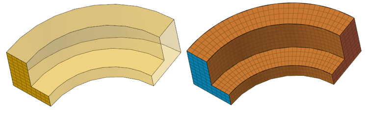

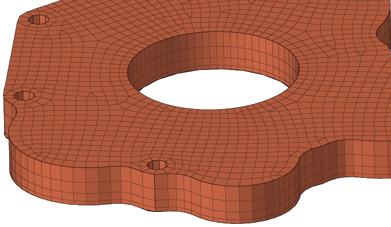

Figure 16. . 1D elements converted to 2D elements along a vector.

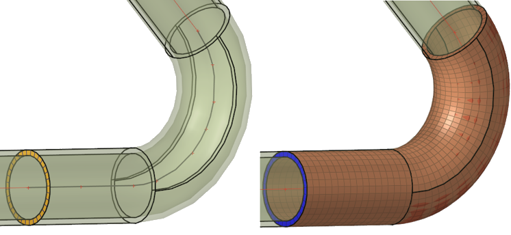

With Guides/Targets (Optional) - Click the Guides selector.
- Select the geometry that defines the face of the 3D volume along
which you wish to map the mesh.

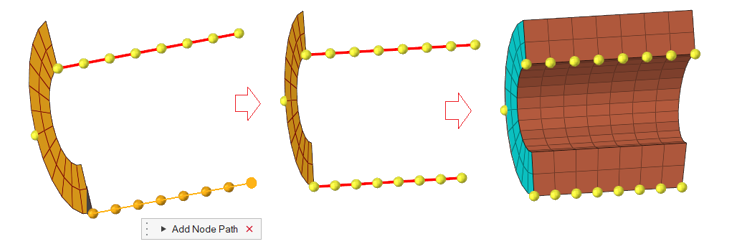

When elements are used, the mapped mesh maintains the nodal positions with selected elements. They can be equivalenced to have common nodes. While selecting nodes, each selection should represent an edge that connects the source and destination.
- Click the Target selector.
- If desired, select geometry that you wish the 3D mesh to match
up with.
Figure 17.

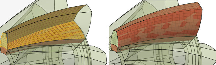

Figure 18. . Mesh created with source elements and a midline as a guide.
Figure 19. . Mesh created with source elements and surfaces/lines as guides.

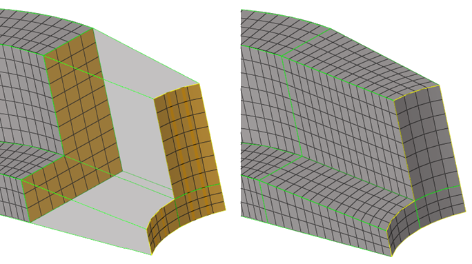

Figure 20. . Mesh created with source elements and multiple faces and elements as guides. Topo(2D/3D) element faces are supported.
Figure 21. . Mesh created with source elements and multiple node paths as guides.
