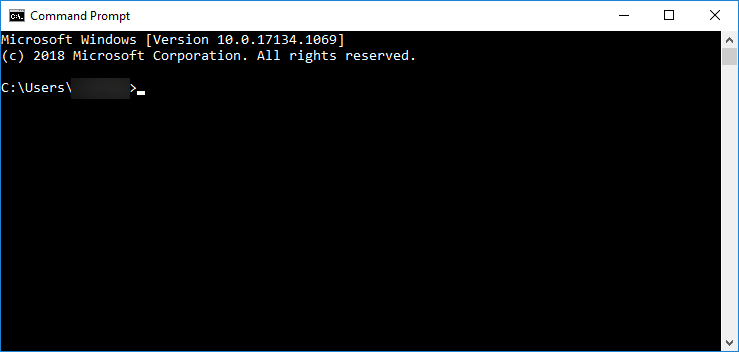

Launch the Command Prompt on Windows or Terminal on Linux.
The Command Prompt opens as seen in Figure 1.
Enter the following content in the Command Prompt.
