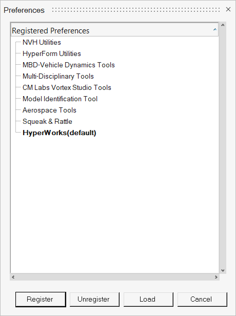

Set the preference file by selecting .
This opens a window which lists all the registered preference files.
- Click Register and then browse for the file new_autosave_bubble_help.mvw.
Select new_autosave_bubble_help.mvw from the list of
Registered Preferences and then click Load to load the
preference file.

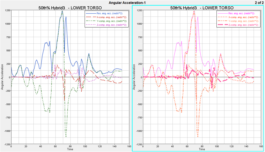

Set the Curve Defaults
- Open TextView.
- From the menu bar, select and open the curve_defaults.mvw file, located in the preferences folder.
- After the *BeginPlotDefaults() line, add the *ResetCurveDefaults() statement to ignore all previous *SetCurveDefaults() statements.
After the *ResetCurveDefaults() line, add the following
preference statements to set the curve defaults:
*SetCurveDefaults(1, 7, 0, 0, 0) *SetCurveDefaults(3, 16, 1, 0, 0) *SetCurveDefaults(5, 24, 2, 0, 0) *SetCurveDefaults(2, 32, 3, 0, 0) *SetCurveDefaults(4, 40, 0, 0, 0) *SetCurveDefaults(5, 48, 1, 0, 0)A plotting preference block can contain several *SetCurveDefaults() statements. The program assigns curve attributes sequentially.
- Save the new preference file to your home directory as new_curve_defaults.mvw by selecting from the menu bar.
Observe the Updated Curve Default Settings
Create a page to add to the session using the page navigation tools in the
upper right corner.
In the new window, click the Change Type icon (
) above the plot window and select
HyperGraph.
Change the page window layout to two windows per page,
- Click to open the Create Curves by File dialog.
Open a plotting file:
- Click the file browser.
- Select the file ANGACC, located in the plotting folder.
- Click Open.
Select the data components and channels to plot:
- Select Angular Acceleration from the Y Type list.
- Select 50th% Hybrid3 – LOWER TORSO from the Y Component list.
- Select the All button from the Y Channel list.
- Click Apply and leave the dialog open.
- Set the file new_curve_defaults.mvw as the preference file by selecting .
Select Register and then browse for the file
new_curve_defaults.mvw.
This automatically loads new_curve_defaults.mvw file as the preference file.
Select new_curve_defaults.mvw from the list and click
Load.
- Click the red X in the upper right corner to close the window.
- If prompted to “Update all plots current default colors”, select No.
- Click on the second plot window on this page.
- Return to the Create Curves by File dialog.
Click Apply.
The color and line styles follow the defaults defined in the new_curve_defaults.mvw file instead of the program system defaults.

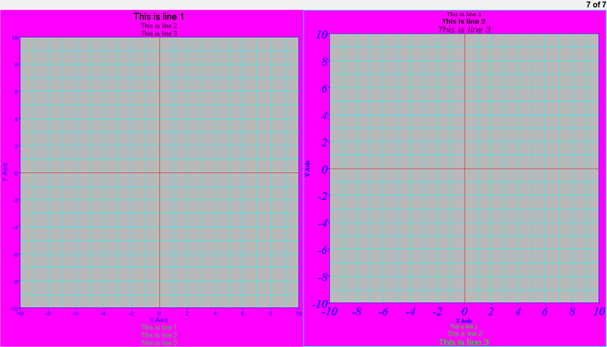

Set the Default Plot Colors
upper right corner.
Figure 4.
TextView.
- From the menu bar, select and open the plot_colors.mvw file, located in the preferences folder.
After the *BeginPlotDefaults() line, add the following
preference statements to set the default plot colors:
*SetBackgroundColor(9) *SetGridlineColor(6) *SetZerolineColor(2) *SetFrameColor(7) *SetAxisColor(4) *SetHeaderColor(0) *SetFooterColor(3) - Save the new preference file as new_plot_colors.mvw in your working directory. You cannot save files back to the default directory.
Observe the Updated Default Plot Colors
- Add a new page and select the HyperGraph.
- Create header and footer text.
- Register and Load the preference file new_plot_colors.mvw. If prompted to "Update all plots current default colors", click No.
- Add a new page, which will activate the new settings.
Note: The colors of the various areas of the plot window reflect the defaults defined in the file new_plot_color.mvw rather than the program system defaults.
Set the Default Fonts for the Plot Area
- Add a new page and select the TextView.
- From the file browser on the toolbar, open the file font_defaults.mvw, located in the preferences folder.
preference statements:
*SetAxisLabelFont("Times New Roman", 1, 0, 8) *SetAxisTicFont("Times New Roman", 0, 1, 18)The first placeholder sets the font name.
The second placeholder sets the font weight. 0 = normal (default), 1 = bold.
The third placeholder sets the slant, or font style. 0 = normal (default), 1 = italic.
The fourth placeholder sets the font size, 8, 10, 12, 14, 18, or 24 points.
Note: If the suggested font is not available on your system, use the name of a font available on your system. -
After the *SetAxisTicFont() line, add the following
preference statements to set the font defaults for the header and footer
text:
*SetLine1HeaderFont("Verdana",0,0,8) *SetLine2HeaderFont("Verdana",1,0,10) *SetLine3HeaderFont("Verdana",0,1,12) *SetLine1FooterFont("Tahoma",0,0,8) *SetLine2FooterFont("Tahoma",0,1,10) *SetLine3FooterFont("Tahoma",1,0,12)Note: If the suggested font is not available on your system, use the name of a font available on your system. - Save the new preference file as new_font_defaults.mvw.
Observe the Updated Default Plot Fonts
- Create a three line header and footer on the plot.
- Register and Load the file new_font_defaults.mvw. If prompted to update to the current defaults, select No.
- Change Page Layout to two windows per page.
- Click on the second plot window on the current page.
The fonts in the plot window reflect the defaults defined in the new_font_defaults.mvw file, including each line of the header and footer area, rather than the program system defaults.

- Register and Load the preference file new_headers_footers.mvw.
