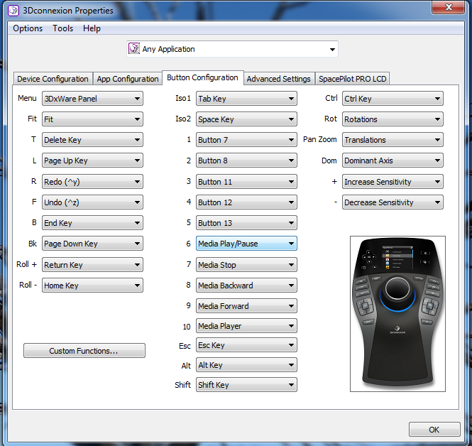

HyperMesh, HyperView, HyperGraph 2D, HyperGraph 3D, and MotionView now support the following SpaceBall or SpaceMouse devices from 3Dconnexion: SpaceNavigator, SpacePilot, SpaceExplorer and SpaceTraveler.
Before running the application, be sure that current drivers are installed for your device. The applications automatically detect and enable the use of the SpaceBall/SpaceMouse once the device is connected and working properly.
The 6 degrees-of-freedom input on the SpaceMouse devices require no special configuration prior to using it within the product, however the 3Dconnexion control panel may be used to adjust the sensitivity of the device, as well as how the axes respond to input.

Custom Button Handler
SpaceMouse button events 11 - 16 are programmed to call user defined Tcl callback handlers. These allow you to customize the SpaceMouse functionality to meet your needs.
