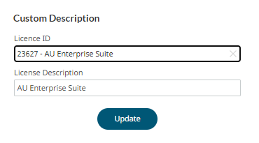

  3. Optional: Select License ID from the drop-down list to add custom description for the licenses.
  4. In License Description, add custom description for the license.
    Figure 2. License Description
  5. Click Update.
    The license description is updated.
