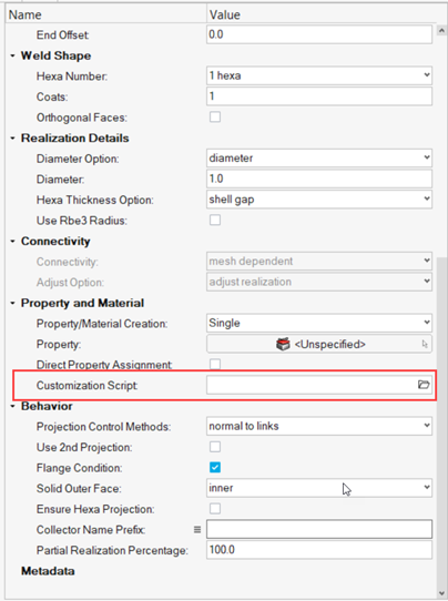

Customization Script
Use the customization script to build on top of an existing realization.
Customization scripts are run after the full realization is done. Any property, materials, contacts, and so on are created in full and the element organization options are completed.
