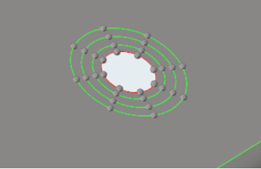

    Offset Lines
    1. Select lines.
    2. Enter an offset distance in the microdialog.
    Note:
    • This option is only available when surfaces are the target.
    • A Washer split anchor is added for quick execution of the split. You can select a line, usually a free edge with a cutout to create the split. This is useful when creating a washer split around a hole. A specific distance can be entered into the microdialog.
