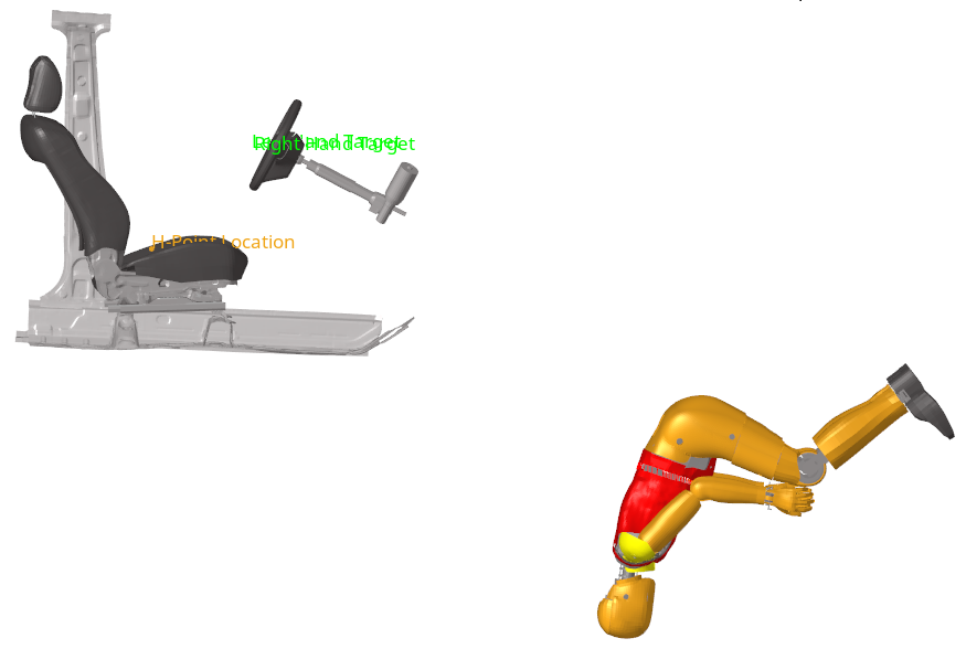

  3. In the Entity Editor, for the Global rotation attribute Rx, enter 180.
    The dummy rotates.

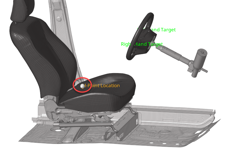

  4. In the modeling window, select the node tagged as H-Point Location as seen in Figure 4.
    Figure 4.
    The dummy automatically moves to the selected H-Point location.

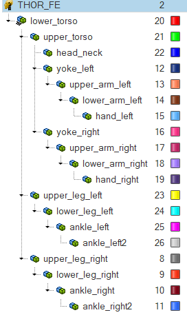

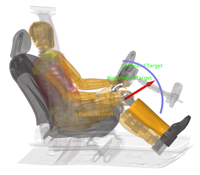

  1. In the Dummy Browser, click the lower_leg_left body entity.
    Figure 6.
    The joint manipulator appears in the modeling window, and the Entity Editor opens.
    Figure 7.
  2. Position the lower leg by completing one of the following:
    • In the modeling window, select the smallest blue arc on the manipulator to interactively position the lower leg to an angle value of -70°.
    • In the Entity Editor, Current angle field, enter -70.

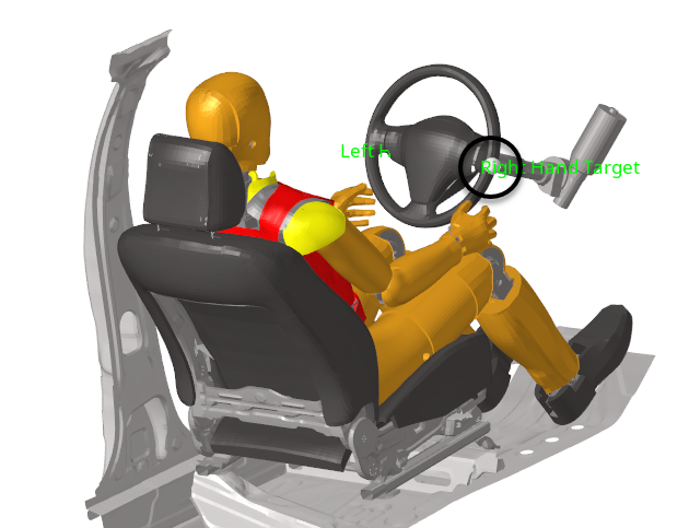

    6. In the modeling window, select the node tagged as Left Hand Target as seen in Figure 8.

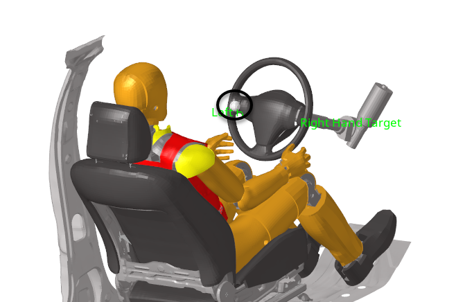

    7. In the modeling window, select the node tagged as Right Hand Target as seen in Figure 9.

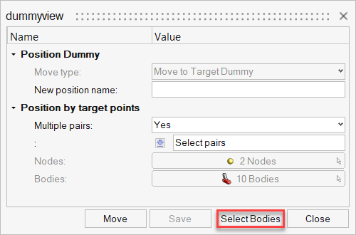

  7. Click Select Bodies.
    Figure 10.
  8. In the Dummy Bodies DOF dialog, enable/disable dummy bodies and body DOFs to be taken into account for the automatic positioning of the dummy limbs.

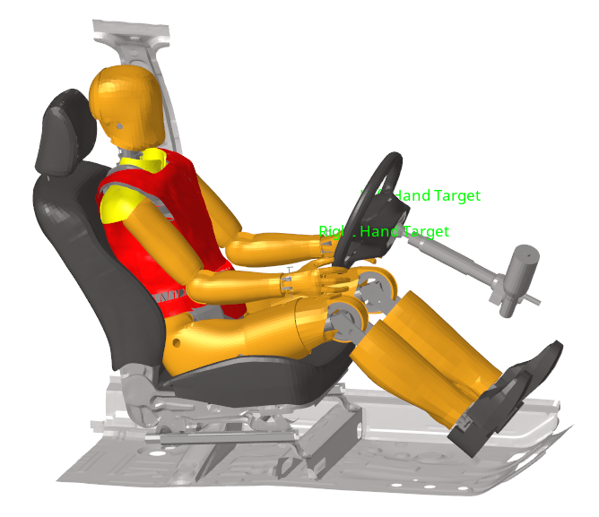

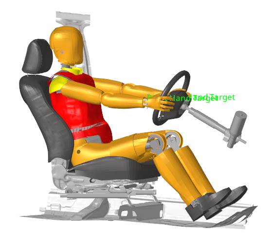

  9. In the dummyview dialog, click Move to activate automatic limbs positioning.
    Figure 11.

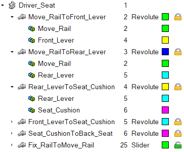

  2. In the Mechanism Browser, expand the Driver_Seat mechanism to observe the different joints and bodies defined.
    Figure 13.

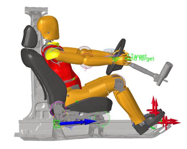

  9. In the Mechanism Browser, right-click the Fix_RailToMove_Rail joint and select Move from the context menu.
  10. In the Entity Editor, Current Distance field, enter -50.0.
    Notice how the dummy moves with the seat and how the position of the legs and feet are updated because of the constraints defined on the feet.
