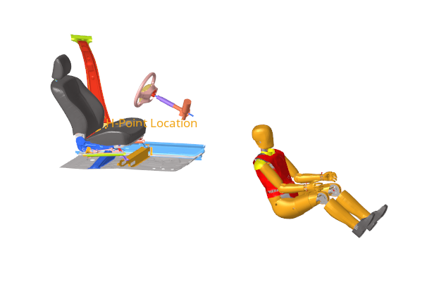

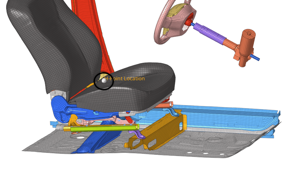

  4. Under H-Point location enter the coordinates.

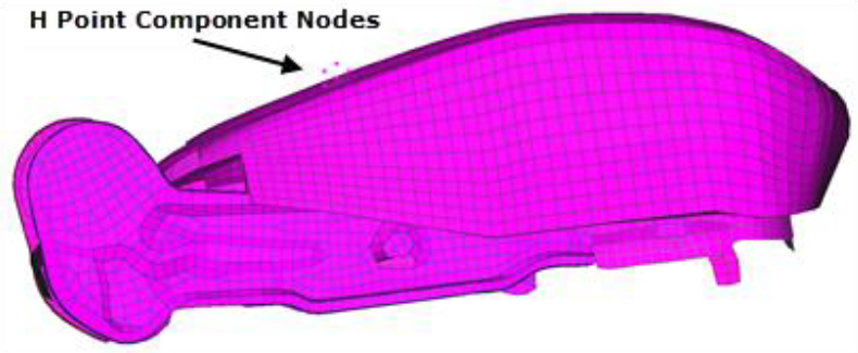

  5. In the modeling window, select the node tagged as H-Point Location on the seat as seen in Figure 4.
    Figure 4.

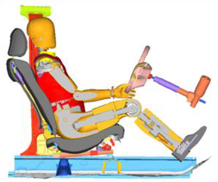

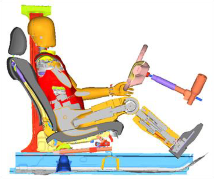

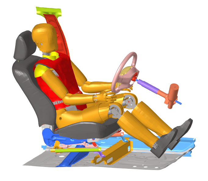

    The dummy automatically moves to the selected HPoint location.
    Figure 5.

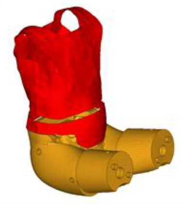

After positioning the dummy to its H-Point location on the seat, intersections between the dummy and seat foam parts occur as seen in Figure 6.

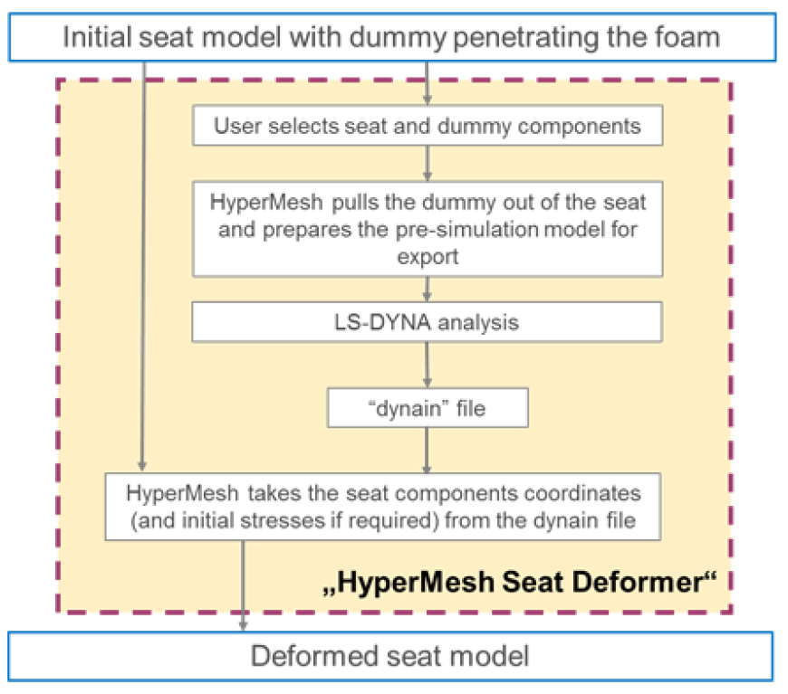

The Seat Deformer tool enables you to export an input deck, for the appropriate solver, in order to simulate the deformation of the seat under the dummy. The simulation result files are then imported to update the initial FE model, and thus remove the intersections and penetrations between the dummy and the seat.

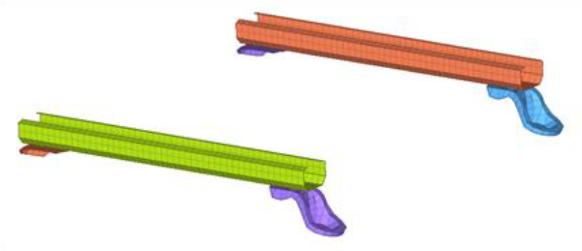

  5. Select the fixed nodes of the seat.
    1. In the Fixed Nodes Of Seat field, click 0 Nodes > Nodes.
    2. In the dialog, select the components depicted in Figure 11 and click OK.

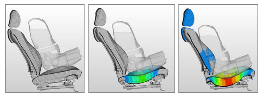

    1. Find the d3plot files in HyperMesh to visualize the animations.
      The displacement fields on the seat should look similar to Figure 12.
