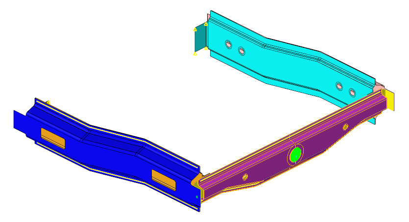

    A finite element model appears in the modeling window.

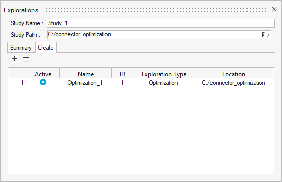

Create an Exploration
  1. From the Design Explorer ribbon, Exploration tool group, click the Create Explorations tool.
    The Explorations dialog opens.
  2. Click then select Optimization.
  3. In the Study Path field, browse to and select the folder to store your Optimization.
    Figure 3.
  4. Close the Explorations dialog.

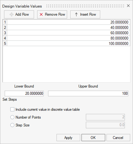

      The Design Variable Values dialog opens.
    6. For Lower Bound, enter 20.
    7. For Upper Bound, enter 100.
    8. Add three more rows and define the Upper Bounds as shown in Figure 6.
      Figure 6.
    9. Click OK.

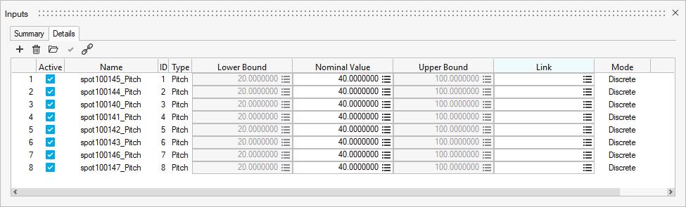

  3. From the Design Explorer ribbon, Connectors tool group, click the Review tool.
    Figure 7.
    The Inputs dialog opens.
  4. From the Inputs dialog, open the Details tab.
  5. Review the design variables.
    Figure 8.

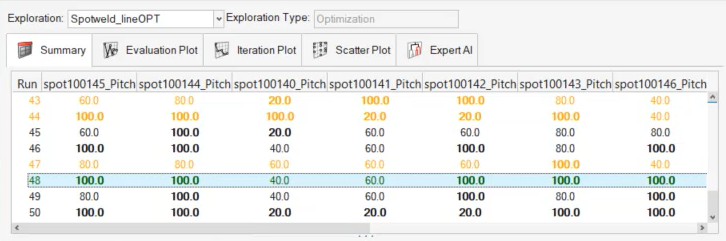

Review the Optimization
  1. From the Design Exploration ribbon, Evaluate tool group, click the Results Explorer tool.
    Figure 14.
    The Results Explorer opens.
  2. Review the optimal run/results, weld pitch values, and resulting response values in the Summary tab.
    Figure 15.
