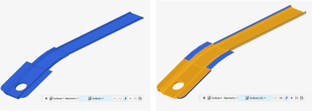

The Attached to function finds entities that are attached or connected to the selected FE or geometry entities.
For example, finding surfaces that are attached to the selected surfaces.
  • - Display the next layer of connected entities.
  • - Find all entities connected to the selected entities. This is equivalent to clicking repeatedly on till there are no more entities that are connected to the selected entities.
  • - Save the found entities to the user mark. Saved selections can retrieved later by right-clicking and selecting Select > Retrieve Selection from the context menu.
Restriction: and are only enabled when the output and input entity types match. For example, finding surfaces attached to selected surfaces.

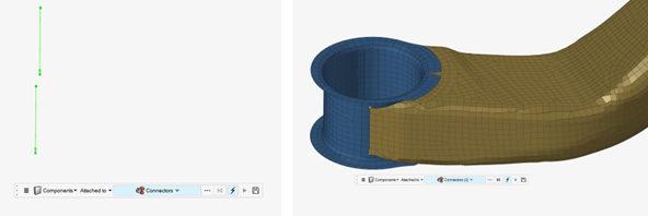

The Attached to function can also be used to find entities that are not the same as the input entity. For example, Figure 2 shows components attached to the selected connectors are found.
