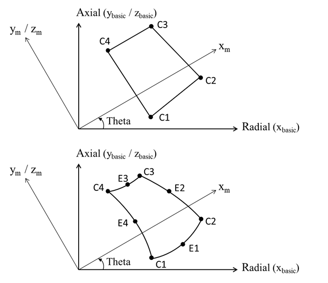

  2. The element grids numbering scheme is controlled by SYSSETTING,AXEGORD,0/1.
    SYSSETTING,AXEGORD Corner Grid Points Edge Grid Points
    C1 C2 C3 C4 E1 E2 E3 E4
    0 (default) G1 G3 G5 G7 G2 G4 G6 G8
    1 G1 G2 G3 G4 G5 G6 G7 G8
  3. All the grid points must be in the x-y plane or in the x-z plane of the basic coordinate system with x = r ≥ 0.
    Corner grid points C1, C2, C3 and C4 must be present. The edge points E1, E2, E3 and E4 are optional. If any of the edge points are present, they all must be used.
    Note that this information is consistent only for the default SYSSETTING,AXEGORD,0. If this is switched to 1, then the corresponding grid point references should be interpreted accordingly.
    Figure 1. CQAXI Definition
  4. The continuation line is optional.
  5. If the PAXI entry referenced in field 3 references a MAT3 entry, material properties and stresses are always given in the (xm, ym) or (xm, zm) coordinate system shown in Figure 1.
