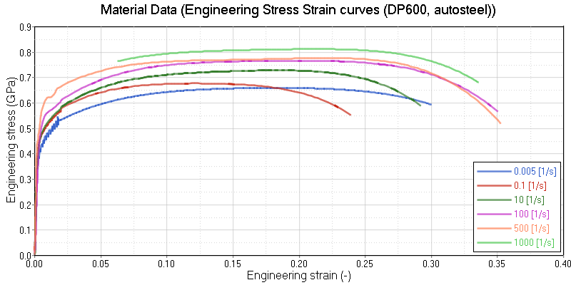

The second model uses the isotropic elasto-plastic material /MAT/LAW36 (PLAS_TAB) where user-defined stress versus plastic strain functions for different strain rates are derived from the real tests. 2 LAW36 will then use a linear interpolation between two different strain rate functions to calculate the material response for a particular strain rate. The input data for the material card is based on strain rate dependent test curves Figure 2. 2

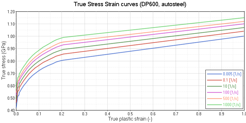

Figure 2. Material Data of Engineering Stress versus Strain for Different Strain Rates. (Steel DP600, original data from autosteel)

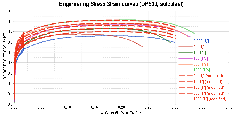

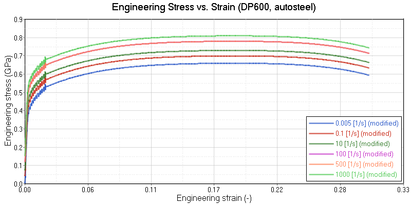

Due to high oscillation and other effects in the tested material (Figure 2), the curves must be modified in order to maintain numerical stability. In this example, the quasi-static curve was chosen as the initial curve and was shifted upwards until the best visual correlation to the other tested strain rate dependent curves was reached. This method avoids the intersections of different curves at higher strain rate regions (Figure 3 and Figure 4). The stress strain for each strain rate must not intersect.
Figure 3. Original and Modified Engineering Stress versus Strain Curves for Different Strain Rates. (Steel DP600, autosteel)
Figure 4. Modified Engineering Stress Strain Curves for Different Strain Rates

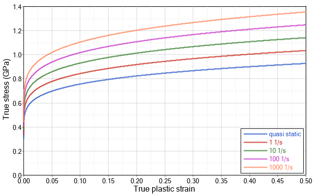

The true stress strain curves were derived from these new modified engineering stress strain curves. These curves were cut at the maximum stress and extrapolated to 100%. The same process described in RD-E: 1101 Elasto-plastic Material Law Characterization for LAW36 was used for each curve to create the following true stress versus plastic strain curves for use in /MAT/LAW36.
Figure 5. True Stress versus True Plastic Strain Curves for Different Strain Rates

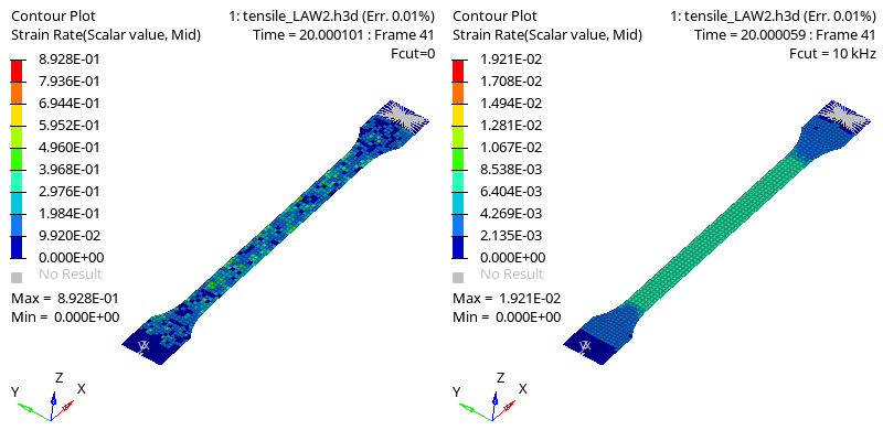

Because of the numerical application of the dynamic loadings, the strain rates are highly oscillating. This can lead to noisy results in the actual and local stress response. To obtain smooth and more physical stress results activate strain rate filtering by setting Fsmooth = 1 and defining a cutoff frequency using Fcut.
The strain rate is filtered using an exponential moving average filter.

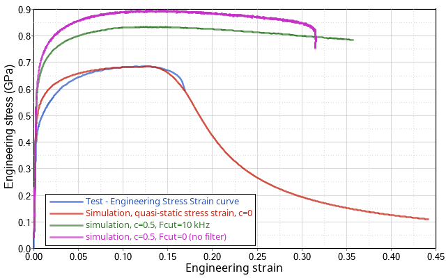

/MAT/LAW2 with Strain Rate Effect
Starting with the LAW2 material input from RD-E: 1101 Elasto-plastic Material Law Characterization, strain rate input was defined ε ˙ 0 = 1x10-4 ms-1 and c MathType@MTEF@5@5@+= feaagKart1ev2aaatCvAUfeBSjuyZL2yd9gzLbvyNv2CaerbwvMCKf MBHbqefqvATv2CG4uz3bIuV1wyUbqedmvETj2BSbqefm0B1jxALjhi ov2DaebbnrfifHhDYfgasaacH8srps0lbbf9q8WrFfeuY=Hhbbf9v8 qqaqFr0xc9pk0xbba9q8WqFfea0=yr0RYxir=Jbba9q8aq0=yq=He9 q8qqQ8frFve9Fve9Ff0dmeaacaGacmGadaWaaiqacaabaiaafaaake aacaWGJbaaaa@39BF@ = 0.05 to demonstrate the functionality (Figure 6 and Figure 7).
Figure 6. Comparison of the Distribution of the Strain Rate in the Specimen without Strain Rate Filtering (Fcut=0) . and with strain rate filtering (Fsmooth=1 and Fcut=10 kHz)
The explicit scheme is an element-by-element method and the local treatment of temporal oscillations puts spatial oscillations into the model. A more physical strain rate distribution is achieved by filtering. Moreover, such results show oscillations in the stress strain curve when not damped by filtering.
The strain rate of the entire tensile test can be calculated by dividing the velocity of the gauge length (velocity of node 616) by the gauge length (80 mm) which results in a strain rate, which ranges from 0.0075 ms-1 at the start of the simulation to 0.01 ms-1 at the end of the simulation. This corresponds well with the strain rate contour plot with strain rate filtering. Since the simulation strain rate speed is larger than the reference strain rate, ε ˙ 0 = 1x10-4 ms-1 the material response is stiffer (Figure 7).
Figure 7. Engineering Stress Strain Curves with and without Strain Rate Filtering /MAT/LAW2

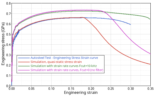

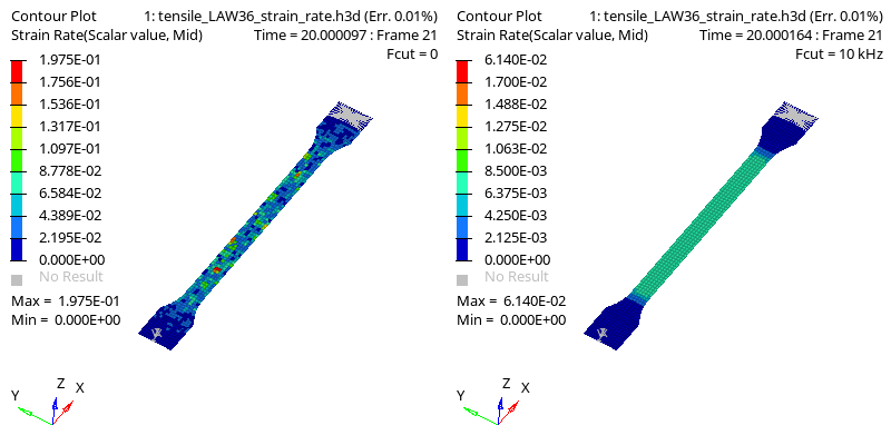

Similar to /MAT/LAW2, the results are smoothed when the strain rate filter is used (Figure 8).
Figure 8. Comparison of the Distribution of the Strain Rate in the Specimen, with and without Strain Rate Filtering /MAT/LAW36
Similar to LAW2, the strain rate contour plot is similar to the strain rate calculated from the gauge length of the tensile test.
Figure 9. Comparison of the Distribution of the Strain Rate in the Specimen, with and without Strain Rate Filtering (/MAT/LAW36) . and engineering stress strain curves without strain rate
As shown in Figure 9, a strain rate larger than the quasi-static test causes the material to be stiffer. The quasi-static and case without a filter, experience material necking which results in the reduction in stress.
