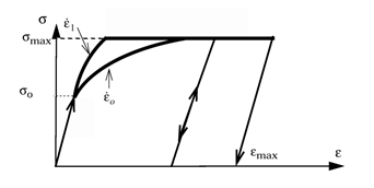

The equivalent stress σ e q is compared to the yield stress σ y which varies in function of plastic strain ε p and the strain rate ε ˙ (LAW32):
σ y = a ( ε 0 + ε p ) n . max ( ε ˙ , ε ˙ 0 ) m
Therefore, the elastic limit is obtained by:
σ 0 = a ( ε 0 ) n . ( ε ˙ 0 ) m
The yield stress variation is shown in Figure 1.
Figure 1. Yield Stress Variation
