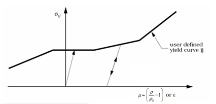

Plasticity may be defined by a volumic strain or strain dependent yield curve (Figure 2). The input yield stress function is always positive. If the material undergoes plastic deformation, its behavior is always orthotropic, as all curves are independent to each other.
Figure 2. Honeycomb Typical Constitutive Curve
The failure plastic strain may be input for each direction. If the failure plastic strain is reached in one direction, the element is deleted. The material law may include strain rate effects (LAW50) or may not (LAW28).

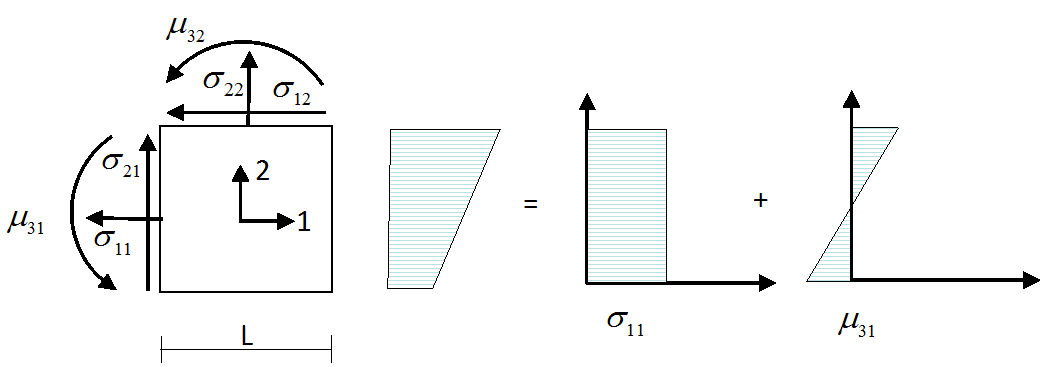

Cosserat effects can arise only if the material is subjected to non-homogeneous straining conditions. A Cosserat medium is a continuous collection of particles that behave like rigid bodies. It is assumed that the transfer of the interaction between two volume elements through surface element dS occurs not only by means of a traction and shear forces, but also by moment vector as shown in Figure 3.
Figure 3. Equilibrium of Cosserat Volume Element
Surface forces and couples are then represented by the generally non-symmetrical force-stress and couple-stress tensors σ i j and μ i j (units MPA and MPa-m):
t i = σ i j n j : m i = μ i j n j
