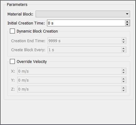

In the Parameters dialog box, specify the following
details:
For Specify Material Block Select a material from the Material Block dropdown list that displays all the saved material blocks within the Material Database that have been transferred to the current simulation deck. Transferring a block from the Material Database to the current simulation also transfers all the relevant Bulk and Equipment materials, interactions, and the Contact Model used.
Without selecting any additional settings, EDEM will place as many copies of the selected block as they fit within the volume of the factory box. This will essentially create a bed of material within the box domain.
Initial Creation Time Specify the time at which the block is created. If you are using Dynamic Block creation. this is the time at which the first block is created. Dynamic Block Creation Select this checkbox to repeat this step every time you set a period in the Create Block Every section. If the Geometry box is the same size as the original saved block, then one block will be created every time period, essentially using the output of one simulation as an input to another. Creation End Time Specify the time at which you want the block creation to end. Create Block Every Select the checkbox to overwrite the stored material velocity with the user-specified value. Override Velocity Select the checkbox to override the velocity of the particles as they are spawned. The velocity can be specified in the X, and/or Y direction.
