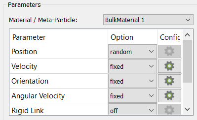

In the Creator Tree, select Geometries and then select
Factories.
In the Parameters dialog box, select an option for Rigid
Link from the Option dropdown list.

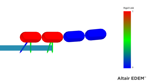

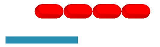

Note: Particle contact radius is applied for the Rigid Link contacts as well.Figure 2. Rigid Link between box and particles with 0.0015m contact radius. Meta-Particles will behave differently if they are linked or not linked with a contact. For example, linking a Meta Particle with a Geometry that it is in contact with will cause only the particle that is in contact with the specified Geometry to be linked. The rest of the particles in the chain will be free to move. If the Meta-Particle is linked to a Geometry that it is not in contact with, all particles in the particles in the chain will be linked. This can only occur when you select On Creation and On Time (link particles in contact is not selected) settings.
Figure 3. Meta-Particle chain is completely linked to the box when the link is applied without contact. Figure 4. Only particles that are in contact with the box are linked and the rest are free to move independently. -

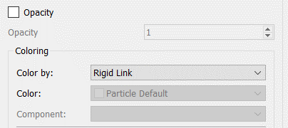

In the Analyst tab, select Rigid Link from the
Color By dropdown list as an additional coloring
option for the particles that are in a Rigid Link bond with a Geometry.
Similar to selecting BondStatus in Contacts, Rigid Link has '1' and '0' as the maximum and minimum values, respectively, for the particles that are in contact and not in contact.
The following images explain the function of the On time setting of Rigid Link:Figure 5. Rigid Link with "On Time" setting of 0.05s Here, the is activated after 0.05 s on particles that are in contact with the Geometry. Other particles can move freely.
Figure 6. Rigid Link with On Time setting and Link only particles in contact only disabled Here, the Rigid Link is activated after 0.02 s, linking the particles with the Geometry. The Rigid Link has been set up to require no contacts to link the particles and Geometry, so that all particles in the contact chain are linked to the moving Geometry.
