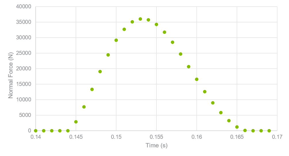

The following example shows a force-time graph for a single particle-geometry collision
where each point is a contact.
