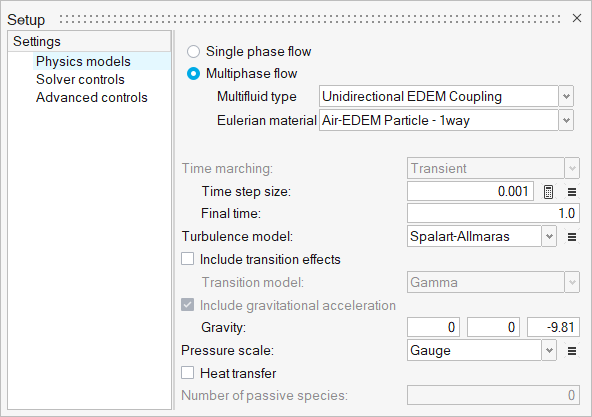

  2. Under the Physics models setting:
    1. Select the Multiphase flow radio button.
    2. Change the Multifluid type to Unidirectional EDEM Coupling.
    3. Set the Eulerian material to Air-EDEM Particle -1way, if not set already.
    4. Set Time step size and Final time to 0.001 and 1, respectively.
    5. Select Spalart-Allmaras as the Turbulence model.
    6. Verify that Gravity is set to 0, 0, -9.81.
    Figure 7.

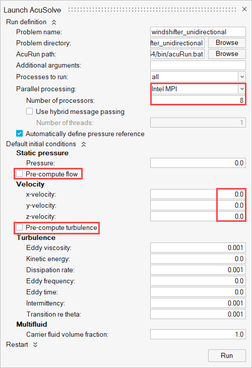

  4. Set the Parallel processing option to Intel MPI.
  5. Optional: Set the number of processors to 4 or 8 based on availability.
  6. Expand Default initial conditions, uncheck Pre-compute flow and set the velocity values to 0. Uncheck Pre-compute Turbulence.
  7. Click Run to launch AcuSolve.
    Figure 35.

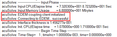

    If the coupling between AcuSolve and EDEM is successful, a message will be printed in the AcuSolve Log file before the first time step.
    Figure 36.

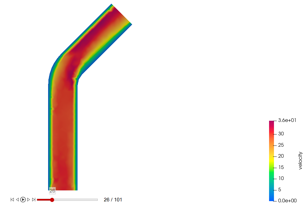

  6. Click the Slice Planes tool.
    Figure 39.
  7. In the modeling window, click on the plane that is parallel to the screen (the x-z plane).
  8. In the slice plane microdialog, click to create the slice plane.
  9. In the display properties microdialog, set the display to velocity and activate the Legend toggle.
  10. Change the upper bound of the legend to 36.
  11. Click and set the Colormap name to Rainbow Uniform.
    Figure 40.
  12. Click on the guide bar.
    The velocity contour should look like the one shown below at the beginning of the simulation.
    Figure 41.
  13. Plot the contours at 0.25s, 0.5s, 0.75s, and 1.0s by dragging the slider on the bottom to the 26th, 51th, 76th, and 101st frames.
    Since the effect of particles on the pressure and velocity fields is not considered for unidirectional coupling, the velocity contours should look similar for all the time frames mentioned above.
    Figure 42.

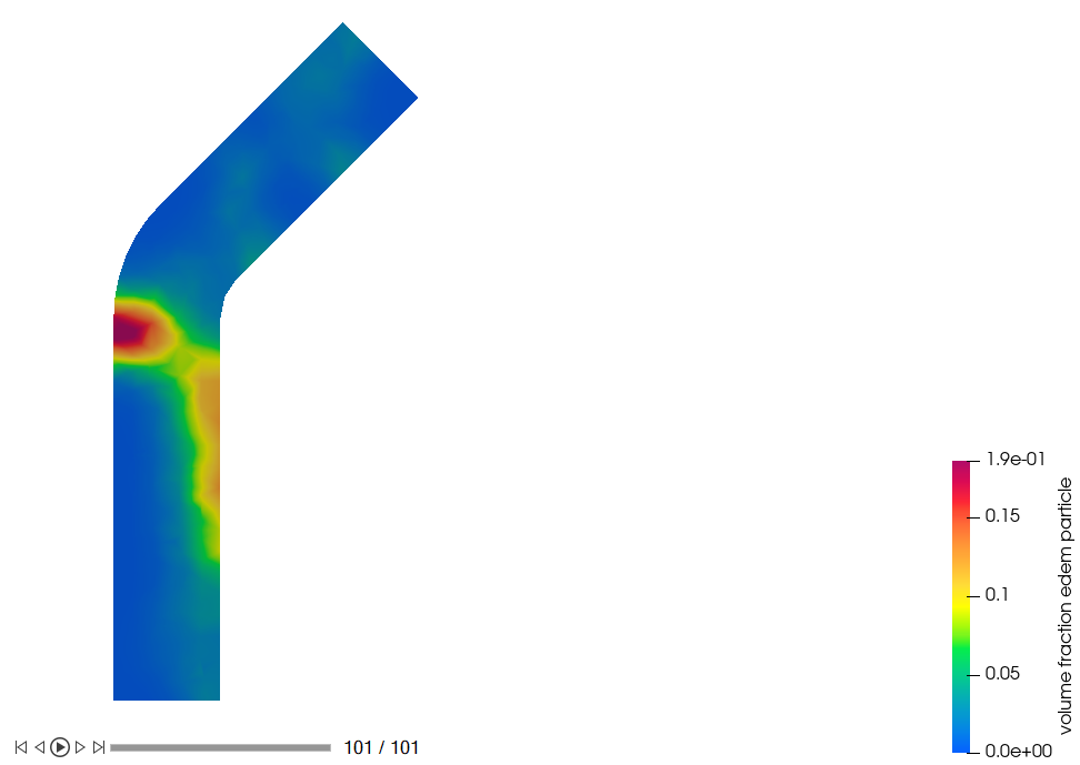

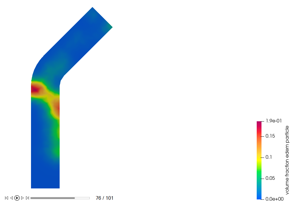

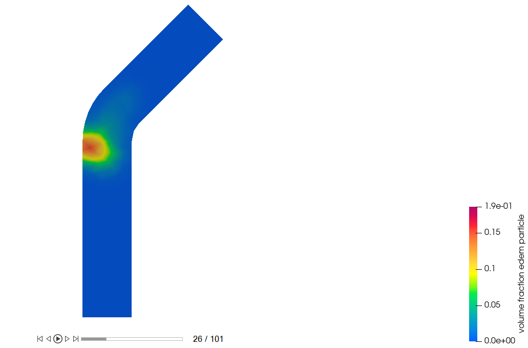

  14. Right-click Slice Plane 1 in the Post Browser and select Edit.
  15. In the microdialog, change the Display variable from velocity to volume fraction edem particle and set the upper bound of the legend to 0.186.
  16. Click on the guide bar.
    Figure 43.
  17. Plot the contours at 0.5s (step=51/101), 0.75s (step=76/101), and 1.0s (step = 101/101) to see the volume fraction edem particle distribution inside the fluid domain.
    Figure 44.
    Figure 45.
    Figure 46.

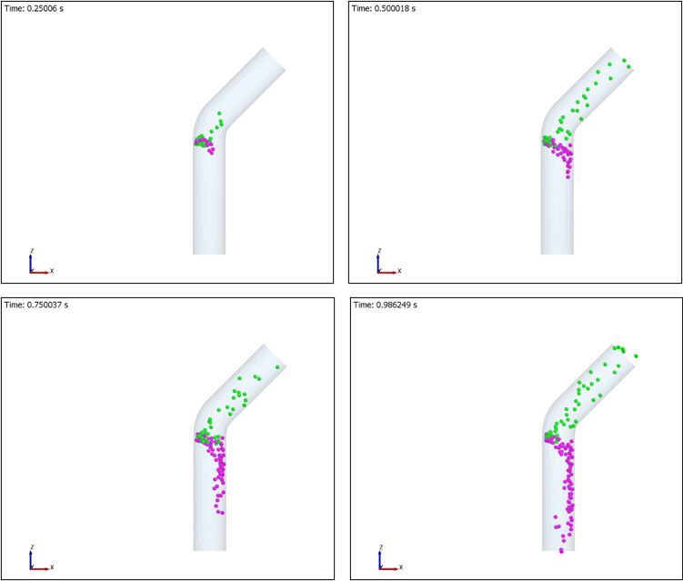

  9. In the Viewer window, set the Playback Speed to 0.1x and then click the play icon to play the particle flow animation.
    Figure 52.
  10. You can also plot the results at different timesteps by clicking the drop-down menu.
    Figure 53.
    For the current case, the results are plotted at 0.25s, 0.5s, 0.75s, and 0.98s to see the particle distribution inside the fluid domain at both inlet and outlet.
    Figure 54.
    Observe that the lighter particles (green) get carried by the fluid and escape the domain through the outlet at the top and the heavier particles (magenta) stay inside the domain for a longer time while some of them fall through the bottom of the pipe.

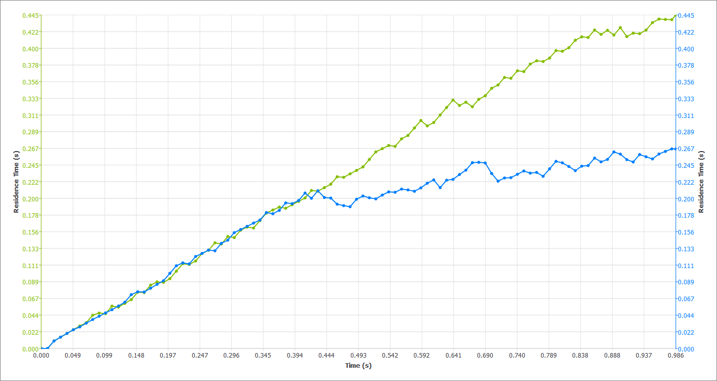

  11. On the menu bar, click the Create Graph icon .
  12. In the Analyst Tree, change the plot type to Line by clicking .
  13. Click on the X-axis tab and verify that the values are set as shown in the figure below.
    Figure 55.
  14. Click the Y-axis tab. Create a plot of average residence time of the heavy particle over the simulation time by setting the values as shown in the figure below.
    Figure 56.
  15. Click to add another Y-axis and set the Type to Light particle.
    Figure 57.
  16. Leave all of the other options unchanged and then click Create Graph to create a plot of average residence time of both the particles.
    Figure 58.
    The plot in green is for the heavier particles and it can be observed that the average residence time is higher for the heavier particles compared to the lighter particles (blue).
