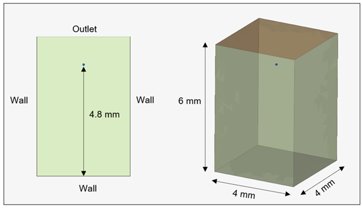

The problem to be solved is shown schematically in the figure below. In this tutorial, you will learn how to write a custom UDF for calculating the drag force on a solid particle in a creeping flow also known as Stokes flow. In Stokes flow, the fluid velocities are generally significantly low, or the fluid viscosities are significantly high and are characterized by very low particle Reynolds numbers (<<1) indicating that the inertial forces are negligible compared to the viscous forces. Stokes flow can be observed in microfluidic devices, blood flow in capillaries, solid particle sedimentation in quiescent fluid, and so on. According to the Stokes drag law, the total drag force (pressure drag plus shear stress drag) on a particle is given by:
The objective of the simulation is to calculate the terminal velocity of the solid particle as it falls through the water column. The particle’s initial location is 4.8 mm from the bottom of the water column. Under Stokes flow, the particle initially accelerates due to gravity and the fluid drag force is negligible. As the particle moves through the fluid, the frictional drag increases and the acceleration reduces to zero over time and thereafter the particle travels with a constant velocity, known as the terminal velocity.

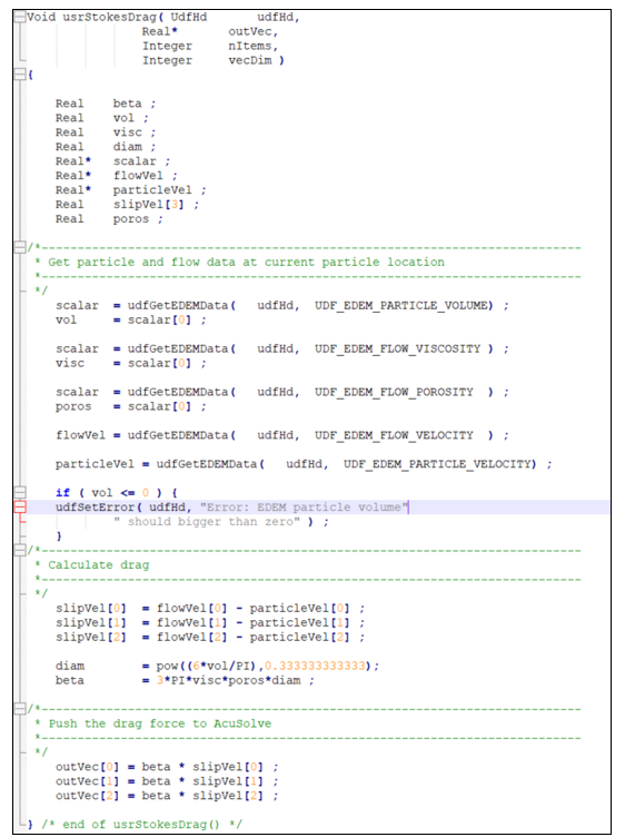

Void usrStokesDrag( UdfHd udfHd,
Real* outVec,
Integer nItems,
Integer vecDim )
Real beta ;
Real vol ;
Real visc ;
Real diam ;
Real* scalar ;
Real* flowVel ;
Real* particleVel ;
Real slipVel[3] ;
Real poros ;
* Get particle and flow data at current particle location
scalar = udfGetEDEMData( udfHd, UDF_EDEM_PARTICLE_VOLUME) ;
vol = scalar[0] ;
scalar = udfGetEDEMData( udfHd, UDF_EDEM_FLOW_VISCOSITY ) ;
visc = scalar[0] ;
scalar = udfGetEDEMData( udfHd, UDF_EDEM_FLOW_POROSITY ) ;
poros = scalar[0] ;
flowVel = udfGetEDEMData( udfHd, UDF_EDEM_FLOW_VELOCITY ) ;
particleVel = udfGetEDEMData( udfHd, UDF_EDEM_PARTICLE_VELOCITY) ;
if ( vol <= 0 ) {
udfSetError( udfHd, "Error: EDEM particle volume"
" should bigger than zero" ) ;

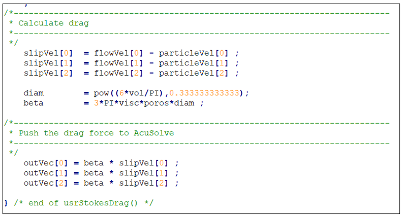

* Calculate drag
slipVel[0] = flowVel[0] - particleVel[0] ;
slipVel[1] = flowVel[1] - particleVel[1] ;
slipVel[2] = flowVel[2] - particleVel[2] ;
diam = pow((6*vol/PI),0.333333333333);
beta = 3*PI*visc*poros*diam ;
* Push the drag force to AcuSolve
outVec[0] = beta * slipVel[0] ;
outVec[1] = beta * slipVel[1] ;
outVec[2] = beta * slipVel[2] ;
} /* end of usrStokesDrag() */

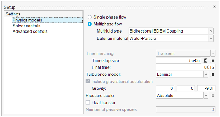

The Setup dialog opens. - Under the Physics models setting, select the Multiphase flow radio button.
- Change the Multifluid type to Bidirectional EDEM Coupling.

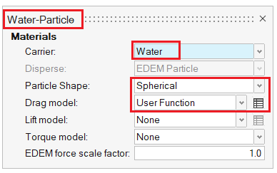

- In the microdialog, click EDEM Bidirectional Material in the top-left corner and change the name to Water-Particle.
- Set the Carrier field to Water.

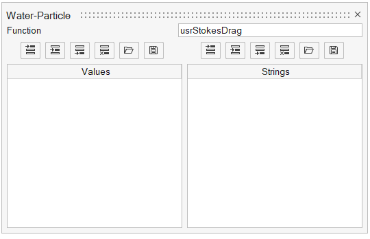

- Verify that the Particle Shape is set to Spherical and set the Drag model to User Function.
Click the table icon beside the drag model drop-down.
Figure 10.
In the new dialog, set the Function name to
usrStokesDrag.
Note: The function name entered here should be the same as the name of the UDF_PROTOTPYE in the UDF. The user-function name can be any name supported in C that starts with the letters usr.
Figure 11.

- In the Setup dialog, set the Eulerian material to Water-Particle.
- Set Time step size and Final time to 5e-05 and 0.015, respectively.
Set the Turbulence model to Laminar.
The calculated particle Reynolds number is less than 0.3 which is in the Stokes regime where the viscous forces dominate the inertial forces and the turbulence effects can be neglected.
- Verify that Gravity is set to 0, 0, -9.81.
Set the Pressure scale to Absolute.

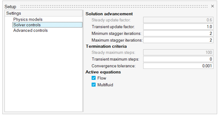

Click the Solver controls setting and set the
Minimum/Maximum stagger iterations to 2,
respectively.
Figure 13.

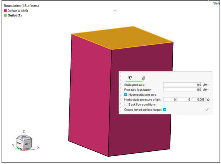

Click the Outlet tool in the
Boundaries group.
Figure 15.
In the modeling window, click the top surface of the
model, which is highlighted in the figure below.
Figure 16.
- In the microdialog, activate the Hydrostatic pressure option and set the Hydrostatic pressure origin to (0, 0, 0.006.)
Click
on the guide bar.
Note: A no-slip wall condition is assigned to all surfaces by default. - Save the model.

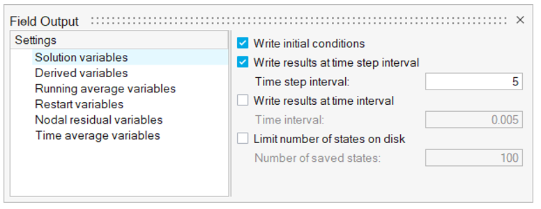

The Field Output dialog opens. - Check the box for Write initial conditions.
- Check the box for Write results at time step interval.
Set the Time step interval to 5.
Figure 19.

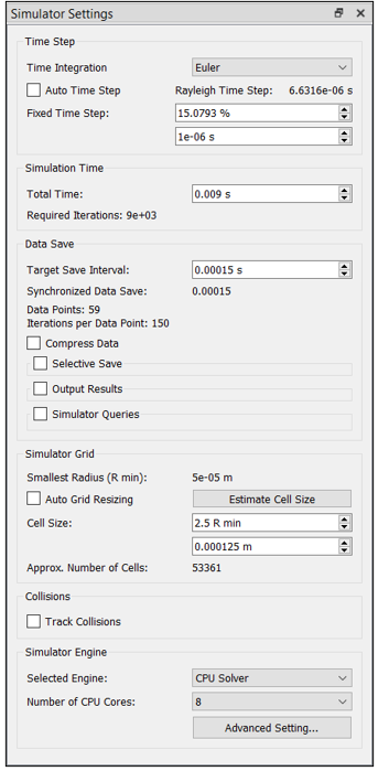

- In the Simulator Settings tab, set the Time Integration scheme to Euler and deactivate the Auto Time Step checkbox.
Enter a value of 1e-6s for Fixed Time Step.
Note: Generally, a value of 20-40% of the Rayleigh Time Step is recommended as the time step size to ensure stability of the DEM simulation. Since the DEM time steps are usually a few orders lower than the CFD time step, for every CFD time step the DEM solver performs multiple iterations to match with the CFD time. Therefore, the CFD time step should always be an integer multiple of DEM time step to ensure that the physical times in both AcuSolve and EDEM match.
- Set the Total Time to 0.015 s and the Target Save Interval to 0.00015 s.
- Set the Cell Size to 2.5 R min.

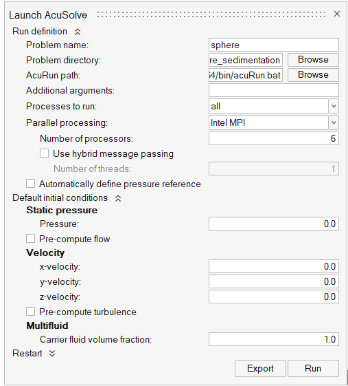

The Launch AcuSolve dialog opens. - Set the Parallel processing option to Intel MPI.
- Set the Number of processors to 6.
- Uncheck Automatically define pressure reference.
- Expand Default initial conditions, uncheck Pre-compute flow and set the velocity values to 0. Uncheck Pre-compute Turbulence.
Click Run to launch AcuSolve.

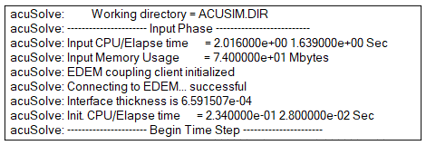

If the coupling with EDEM is successful, that information is printed in the .log file.
Figure 26.

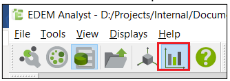

Once the EDEM simulation is complete, click
in the top-left corner to go to
the EDEM Analyst tab.
Click the Create Graph icon.

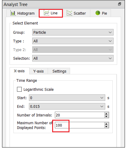

In the Analyst tree, select the Line plot and make sure
that the parameters for X-axis are set as shown in the figure below.
Figure 28.

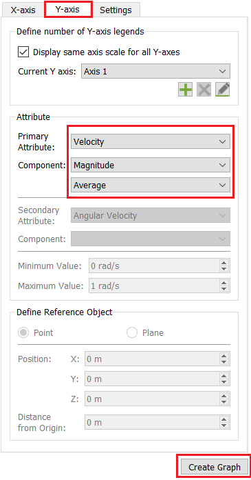

- Click the Y-axis tab and set the Primary Attribute to Velocity and the Component to Magnitude (Average).
Click Create Graph.

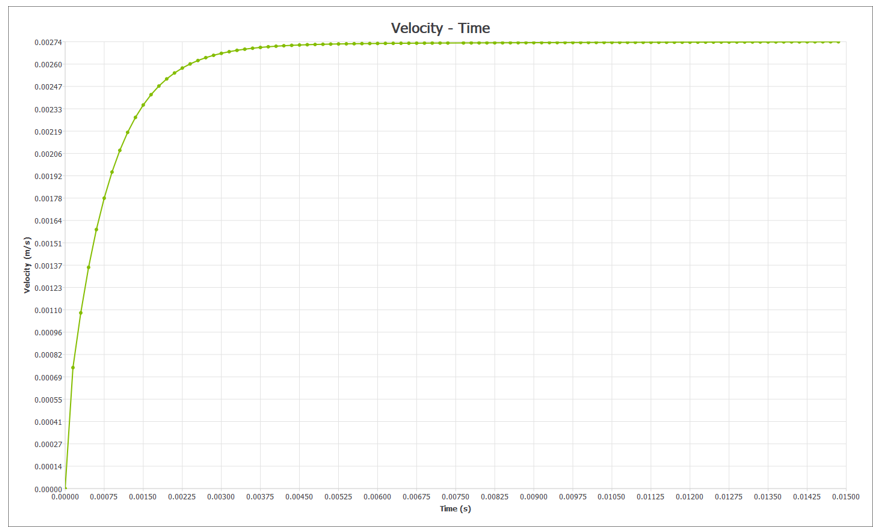

Figure 29.
The particle velocity vs time plot displays in the plot window.Figure 30.
As expected, at the beginning of the simulation, the particle accelerates from zero-velocity because of gravity. As the particle moves and displaces the surrounding fluid, the frictional drag on the particle increases and due to the combined effect of buoyancy and drag force, the acceleration reduces to 0 and the particle moves with a constant velocity. This is known as the particle terminal velocity and in this case the predicted value is 0.00274 m/s which is very close (0.5% error) to the analytical solution (0.002725 m/s). This shows that the Stokes drag law is very accurate in predicting the fluid-induced drag forces for creeping flows.
