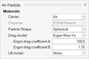

In the Material Library dialog, select EDEM 2 Way
Multiphase, switch to the My Material
tab, then click
to add a new material model.
- In the microdialog, click EDEM Bidirectional Material in the top-left corner and change the name to Air-Particle.
- Set the Carrier field to Air (if not set already).
Set the drag model and the drag coefficients as shown in the figure
below.
Figure 7.
- Close the material model microdialog and then close the Material Library dialog.

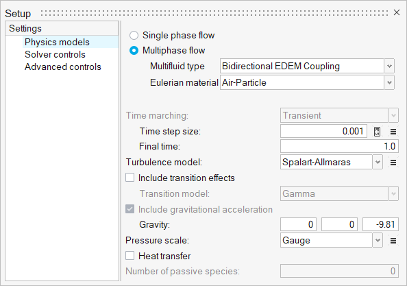

- In the Setup dialog, set the Eulerian Material to Air-Particle.
Set Time step size and Final time to 0.001 and
1, respectively. Select
Spalart-Allmaras for the Turbulence model. Verify
that Gravity is set to 0, 0, -9.81, as shown below.
Figure 8.

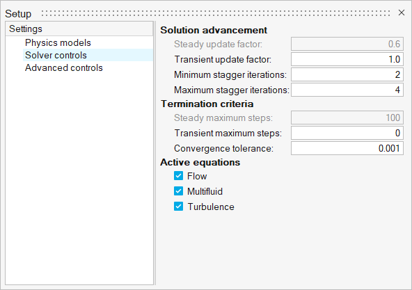

Click the Solver controls setting and set the Minimum
and Maximum stagger iterations to 2 and
4, respectively.
Figure 9.

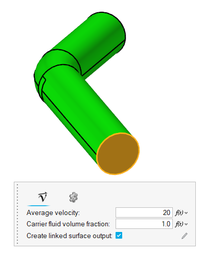

From the Flow ribbon, Profiled
tool group, click the Profiled Inlet tool.
Figure 11.
Click on the inlet face highlighted in the figure below. In the microdialog, enter a value of 20 m/s
for the Average velocity and set the Carrier fluid volume fraction to
1.0.
Figure 12.

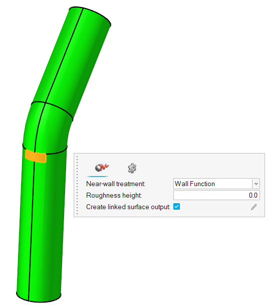

Click the No Slip tool.
Figure 15.
Select the face highlighted in the figure below.
Figure 16.
In the Boundaries legend, double-click Wall and rename
it to Particle_inlet.
You will use this surface as a reference geometry to create a particle factory in EDEM. Hence, you are placing this surface in a different geometry group.

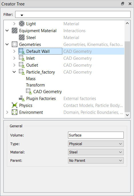

- Expand Geometries under the Creator Tree tab. Next, right-click the Particle inlet surface group and select .
- Rename the new geometry section to Particle_factory.
- Right-click the Default Wall geometry section in the Creator Tree and select Merge Geometry(s).
- In the Merge Geometry dialog, select the Particle_inlet and then click OK.
Click the Default Wall geometry section, set the Type to
Physical, and the Material to
Steel (if not set already).
Figure 29.
- In the Creator Tree, click the Inlet section and change the Type to Virtual.
- Similarly, change the Type to Virtual for the Outlet and Particle_factory sections.

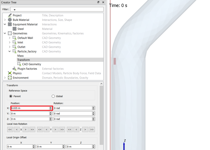

Under Particle_factory, click Transform. Set the
X-Position to 0.035 m
Figure 30.
Note: Set the Opacity value to 0.2 to see the transformed surface location inside the pipe geometry.This is done to make sure that the particles are generated inside the fluid domain.

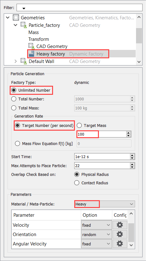

- In the Creator Tree, right-click Particle_factory and select Add Factory.
- Rename the new factory to Heavy factory.
Set the particle generation parameters as shown in the figure below.
Figure 31.
Click
besides Velocity, set the
X-velocity to 1 m/s, and then click OK.

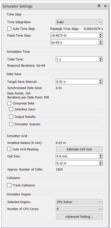

In the Simulator Settings tab, set the Time Integration scheme to
Euler and deactivate the Auto Time
Step checkbox.
Note: The Auto time step should never be used for AS-EDEM bidirectional coupled simulations.
Enter a value of 2e-5 for Fixed Time Step.
When setting the time step for the DEM model, make sure that the CFD time step is an integer multiple of DEM time step. In this case, the CFD time step is 1e-3, which is 50 times the DEM time step. This ensures that the physical time in both the solvers match at the end of each data exchange interval. Also, the recommended range for the CFD-to-DEM time step ratio is 50-200 for most cases.
- Set the Total Time to 1 s and the Target Save Interval to 0.01 s.
Set the Cell Size to 4 R min.
Generally, a value in the range of 3-6 Rmin is recommended as the optimum cell size. The cell size in EDEM does not have any impact on the accuracy of the simulation and affects only the run time.
Set the Selected Engine to CPU Solver and set the Number
of CPU Cores based on availability.
Figure 32.
- Once the simulation settings have been defined, save the model.

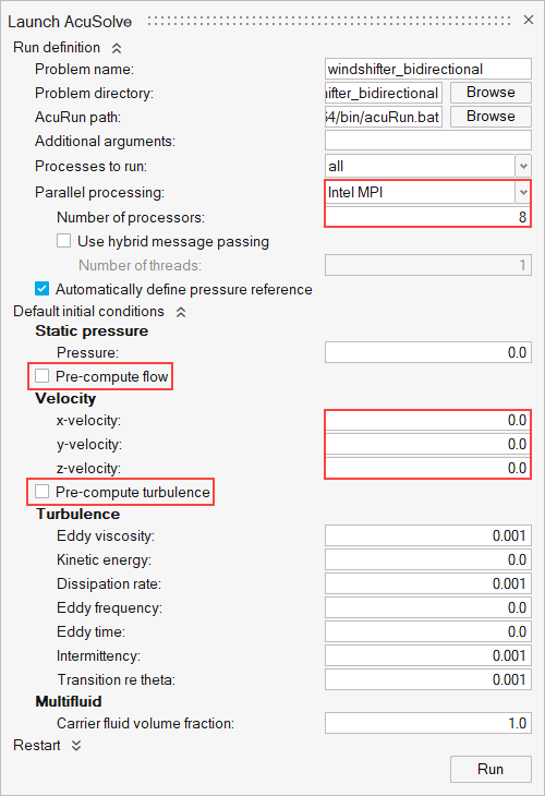

The Launch AcuSolve dialog opens. - Set the Parallel processing option to Intel MPI.
- Expand Default initial conditions, uncheck Pre-compute flow and set the velocity values to 0. Uncheck Pre-compute Turbulence.
Click Run to launch AcuSolve.

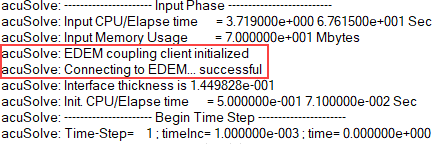

Figure 36.
If the coupling between AcuSolve and EDEM is successful, a message will be printed in the AcuSolve Log file before the first time step.Figure 37.

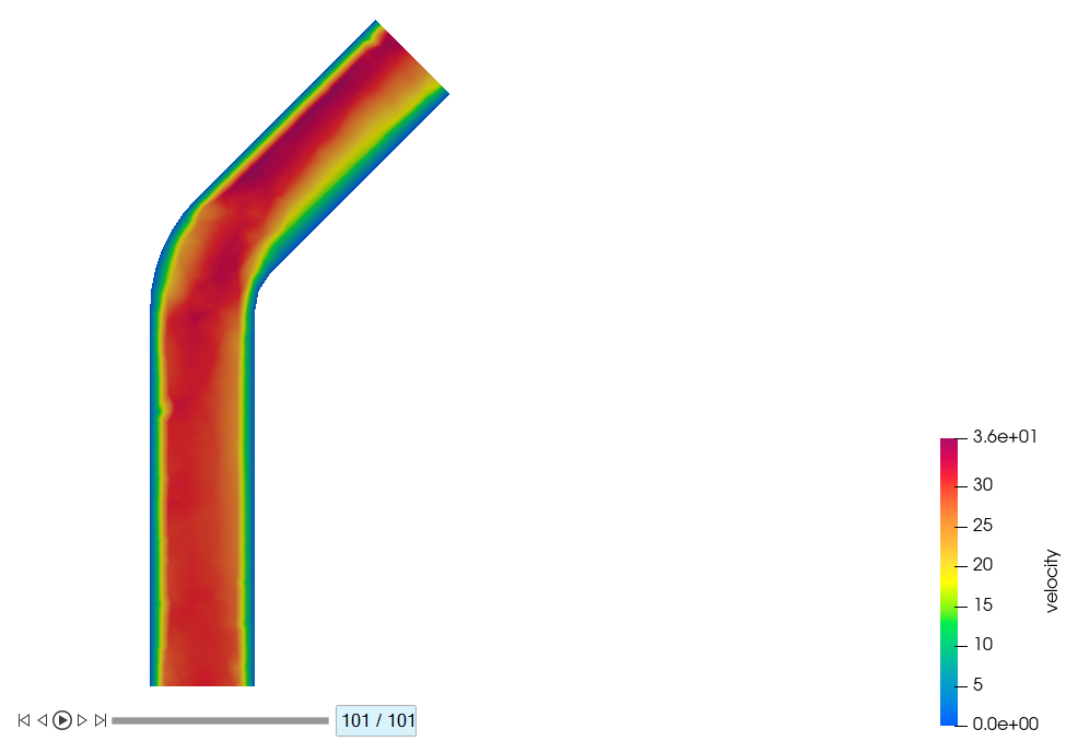

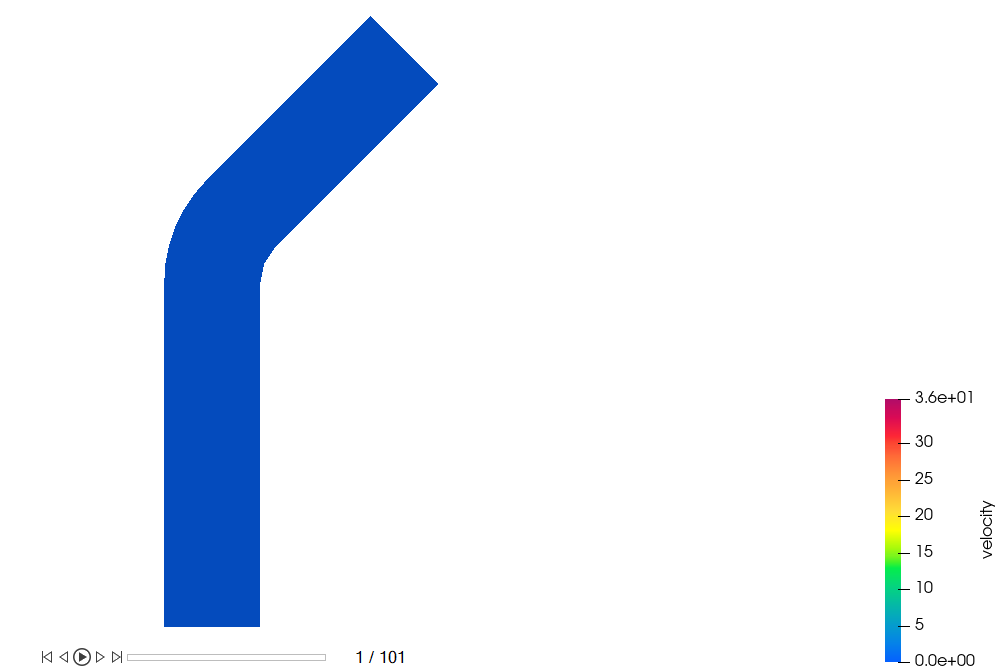

Analyze the Results
AcuSolve Post-Processing
- Once the solution is completed, navigate to the Post ribbon.
- From the menu bar, click .
Select the AcuSolve
.log file in your problem
directory to load the results for post-processing.
The solid and all the surfaces are loaded in the Post Browser.

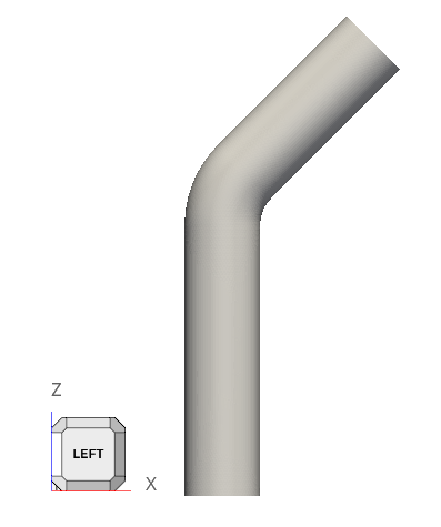

Select the Left face on the view cube to align the model
to the x-z plane.
Figure 38.

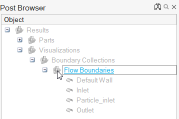

In the Post Browser, turn off the display of the boundary
surfaces by clicking on the icon next to Flow Boundaries.
Figure 39.
Click the Slice Planes tool.
Figure 40.
- In the modeling window, click on the plane that is parallel to the screen (the x-z plane).

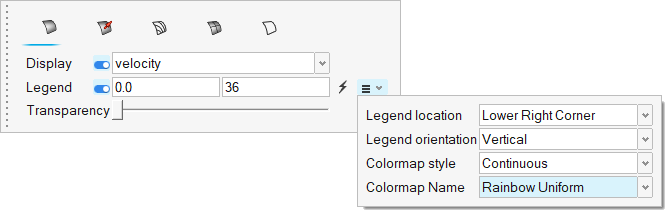

- In the display properties microdialog, set the display to velocity and activate the Legend toggle.
- Change the upper bound of the legend to 36.
Click
and set the Colormap name to Rainbow
Uniform.

The velocity contour should look like the one shown below at the beginning of the simulation.Figure 42.

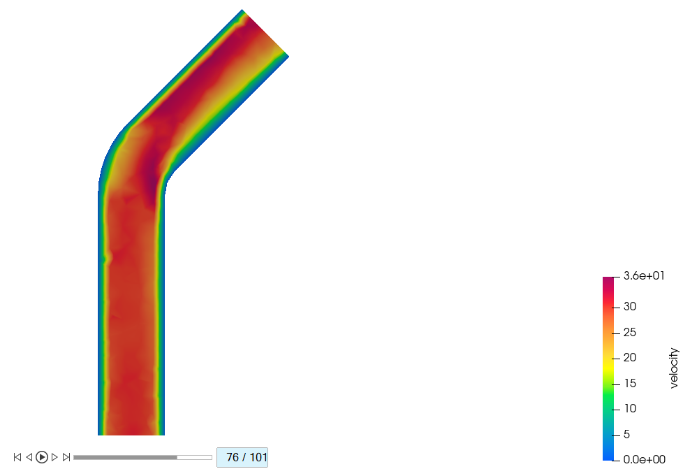

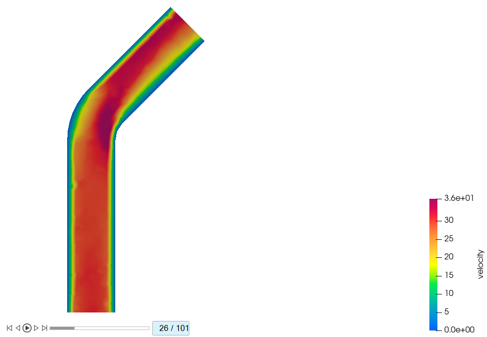

Plot the contours at 0.25s, 0.5s, 0.75s, and 1.0s by dragging the slider on the
bottom to the 26th, 51th, 76th, and
101st frames.
Figure 43.
Figure 44.
Figure 45.
Figure 46.

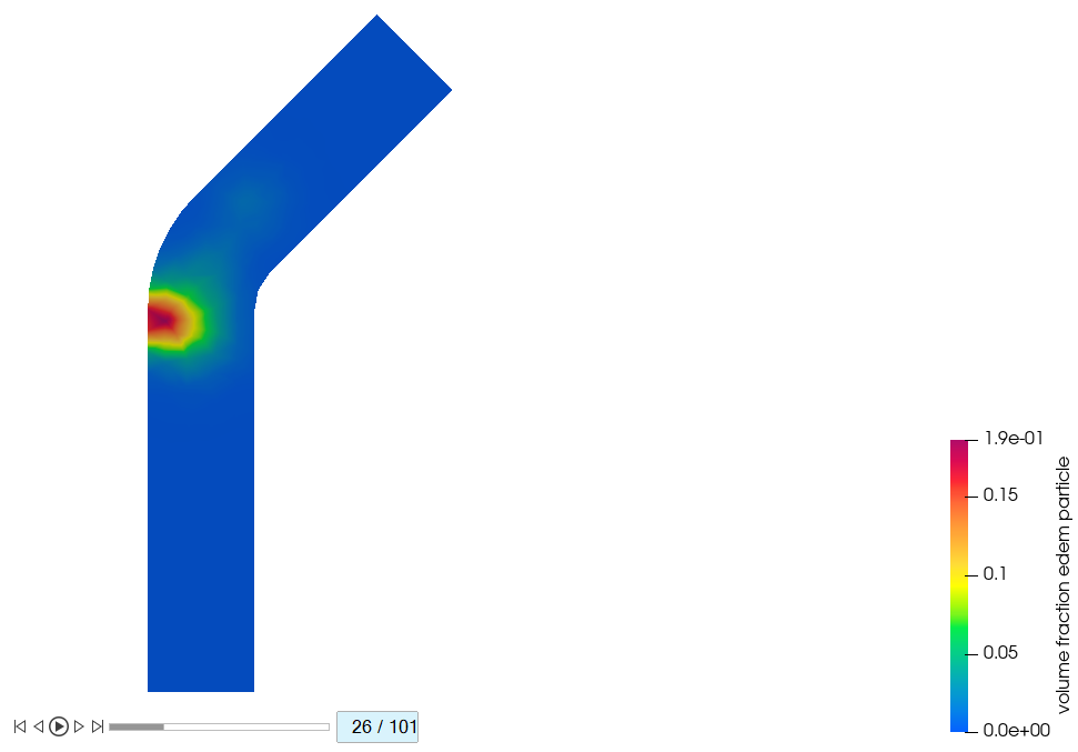

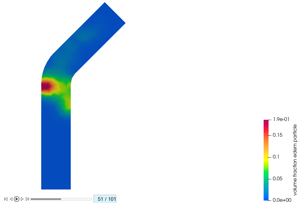

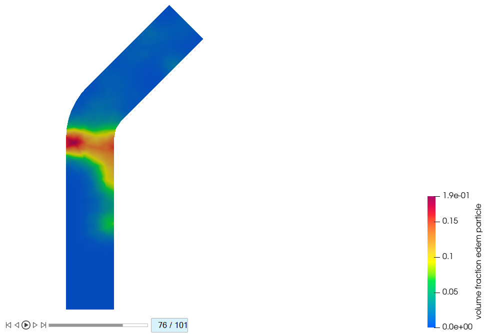

- Right-click Slice Plane 1 in the Post Browser and select Edit.
- In the microdialog, change the Display variable from velocity to volume fraction edem particle and set the upper bound of the legend to 0.186.
Click
on the guide bar.
Figure 47.
Plot the contours at 0.5s (step=51/101), 0.75s (step=76/101), and 1.0s (step =
101/101) to see the volume fraction edem particle distribution inside the fluid
domain.
Figure 48.
Figure 49.
Figure 50.

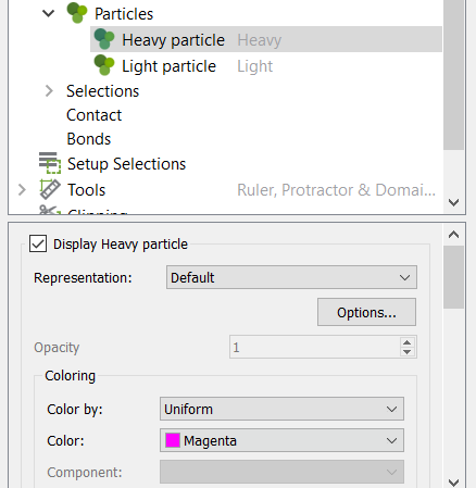

- In the Analyst Tree, expand Particles and click Heavy particle.
Change the display color to Magenta.
Figure 52.

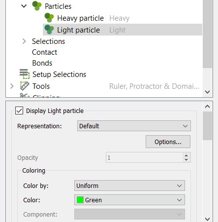

Click on Light particle and set the display color to
Green.
Figure 53.

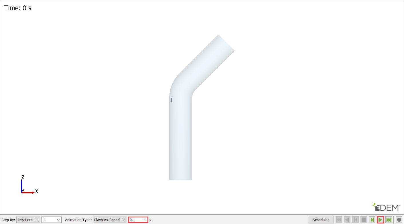

On the menu bar, set the time to
0 by clicking:
Figure 54.
Set the View plane to + Y.
Figure 55.
In the Viewer window, set the Playback Speed to 0.1x
then click on the play icon to play the particle flow animation.
Figure 56.

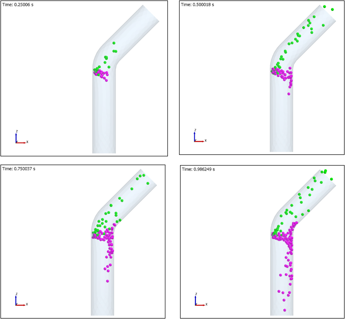

You can also plot the results at different timesteps by clicking the drop-down
menu.
Figure 57.
For the current case, the results are plotted at 0.25s, 0.5s, 0.75s, and 0.98s to see the particle distribution inside the fluid domain at both inlet and outlet.Figure 58.
Observe that the lighter particles (green) get carried by the fluid and escape the domain through the outlet at the top and the heavier particles (magenta) stay inside the domain for a longer time while some of them fall through the bottom of the pipe.

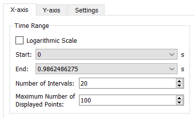

On the menu bar, click the Create
Graph icon
In the Analyst Tree, change the plot type to Line by clicking
Click the X-axis tab and verify that the values are set
Figure 59.

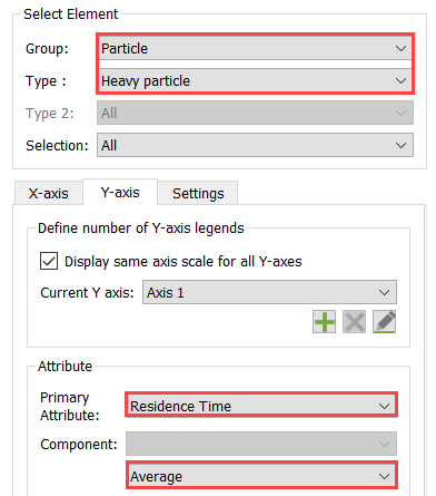

Click the Y-axis tab. Create a plot of average residence
time of the heavy particle over the simulation time by setting the values as
Figure 60.

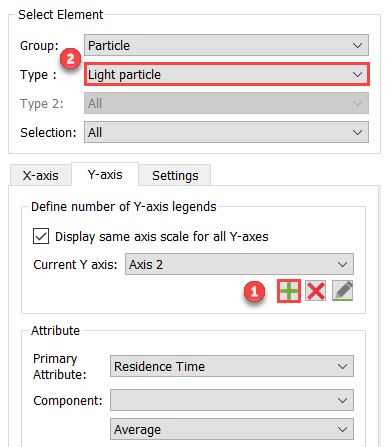

Click
to add another Y-axis and set
the Type to Light particle.
Figure 61.
Leave all the other options unchanged and then click Create
Graph to create a plot of average residence time of both the
particles.
Figure 62.
The plot in green is for the heavier particles and it can be observed that the average residence time is higher for the heavier particles compared to the lighter particles (blue).
