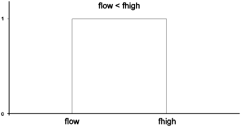

To create a band-pass filter, specify a high cutoff frequency (fhigh) that is greater than the low cutoff frequency (flow).

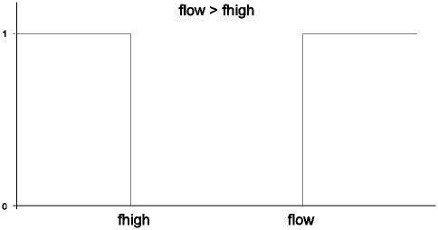

To create a notch filter, specify a high cutoff frequency (fhigh) that is less than the low cutoff frequency (flow).
