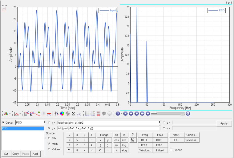

Example
| Curve Math Vectors | Results |
p1w1c1.x = (0:255:1)/512 |
Given c1, a curve is created which contains the values of 1 + x2 from 0 to 10. |
p1w1c1.y = 6 +
The vector of signal amplitude samples. |
x = fold(freq(p1w1c1.x))/2 |
The vector of frequencies. |
y = fold(psd(p1w1c1.x, p1w1c1.y)) |
The vector of PSD values. |
The fold function is used with x and y to display the one-sided spectrum above.

The example PSD computations can simplified as follows.
PSD(0) = 6^2 * (256/512) = 18
PSD(20) = 0.5 * 10^2 * (256/512) = 25
PSD(50) = 0.5 * 8^2 * (256/512) = 16
The leading 0.5 factor in the PSD(20) and PSD(50) values comes from the RMS power of the sinusoid components.
