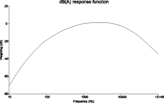

Acoustic A-weighting function.

The dba function returns the A-weighted frequency curve for the input curve. The A-weighting dampens the non-audible components of the input curve.
