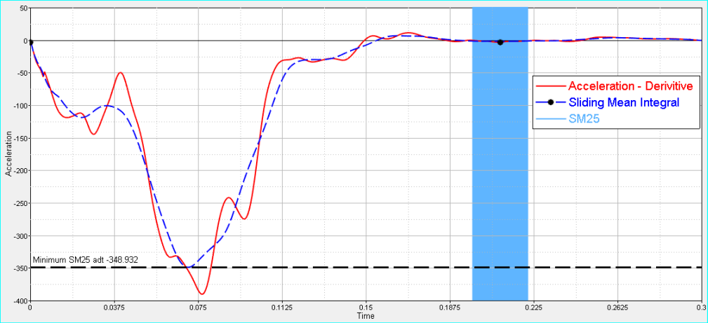

smean (sliding mean integral)
Sliding mean integral filter. Smooths the curve by moving a sliding window over the curve and calculating the mean value. This is done by calculating the area of the sliding window regardless of whether or not there are points at the window boundary, and divides this area by the window size.
