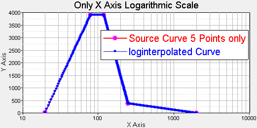

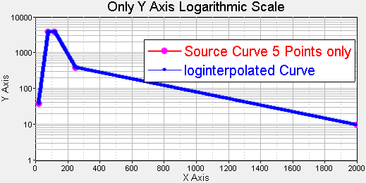

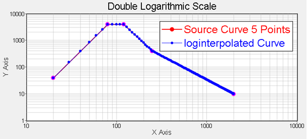

- 0 - results in both axes being logarithmically scaled.
Example
Flag 0 results in both axes ben logarithmically scaled.
