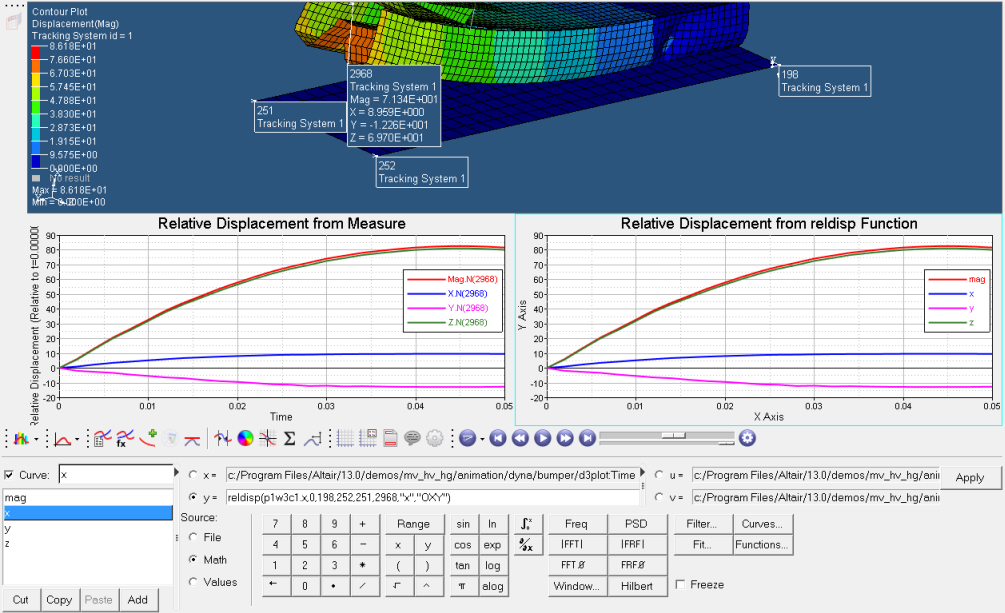

Example
Comments
This allows you to see the relative displacements in the higher sampling rate normally provided by time history results.
