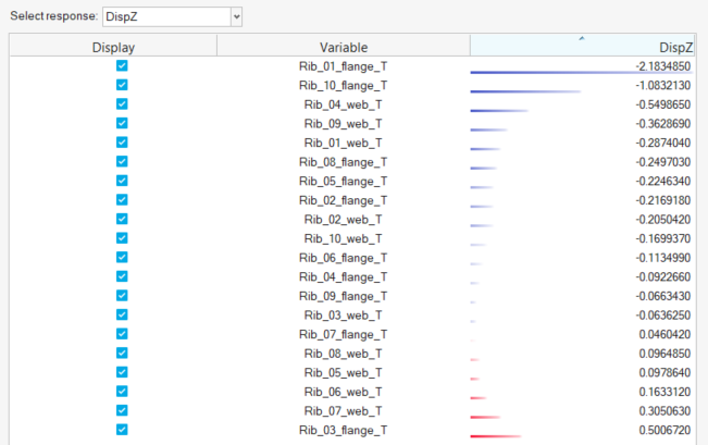

- Select an output response from the Select response drop-down menu.
Visualize the results using the table and the modeling window.

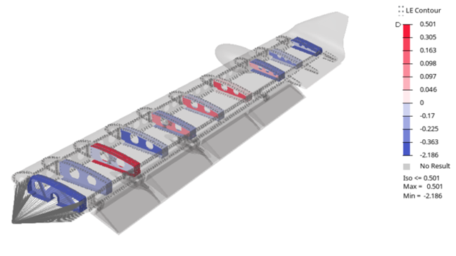

The linear plot in the Results Explorer Browser shows the relative effect that a design variable has on the model for a selected response. The larger the number, the larger the impact of the given variable, relative to the other variables. The coloring of the effects indicates whether a given effect has a positive or negative effect.Positive effects are shown in shades of blue and indicate that a positive change in the design variable results in a positive change on the response.Negative effects are shown in shades of brown and indicate that a positive change in the design variable results in a negative change on the response. For example, an increase in the Rib_01_flange thickness variable is expected to result in a significant decrease in the Z-displacement response, relative to all other variables.
The contour plot and legend in the modeling window help you to further visualize the linear effects.
Figure 3.
- Select rows in the plot table to isolate and locate the given variable in the model.
