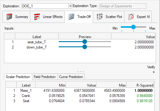

The Trade-off panel is divided into four areas: Inputs, Scalar Prediction, Field Prediction, and Curve Prediction.
- Inputs
- Each row in the Inputs area corresponds to an input or design variable in the exploration. Moving the sliders, or keying in values in the Value column, sets the desired value for the given design variable.
- Scalar Prediction
- Predicted response values are shown based on a response surface fit automatically generated for every DOE.
- Field Prediction
- Using advanced machine learning techniques, predicted results are calculated and contoured for the entire model.
- Curve Prediction
- Predicted curves are calculated based on response selection and defined inputs or design variables.
- In the Inputs area, move the sliders to the desired values, or type values into the Value column.
Review the predicted response values in the Scalar Prediction tab.
Note:
- The Min and Max values in the indicate the minimum and maximum sampled values for the given responses based on the DOE results.
- The R-Squared value is a statistical representation of the quality of a given response fit based on cross validation. R-Squared values are color-coded to indicate the level of confidence that should be attributed to a given fit. The trade-off tool is very useful for showing trends. It is recommended that a verification run be performed to validate a predicted response.

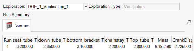

Click the Verify button, Export,
and Run a verification.
A verification is an exploration where a single solver job is run with the input design variable values set as they were in the trade-off panel.
Figure 3.
Results for the verification exploration run can be used to verify the predictions. The results can be viewed in the Results Explorer by setting the verification exploration as the exploration.Figure 4.
