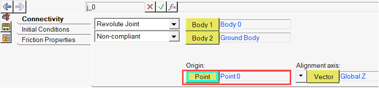

Activate a point collector on any panel.
Figure 1. Activated point collector on a joint panel

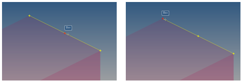

Points can be added using following graphics entities:- Straight edge (edge center or at either ends)
Figure 2. Point on edge at center, Point on edge at end

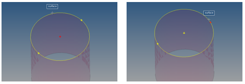

- Closed/Open circular edge (at either ends or circle/arc center)
Figure 3. Point at closed circle center, Point at closed circle end
