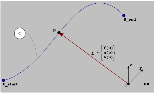

A Parametric curve is defined in terms of one free parameter, u. Referring to the image below, assume a curve C is defined with respect to a coordinate system OXYZ. The coordinates of any arbitrary point on the curve P, as measured in OXYZ, can be represented uniquely in terms of the free parameter u with three functions, f(u), g(u), and h(u), that define the x-, y- and z-coordinates of P. The extent of the curve is governed by the start and end values of u. This is a parametric representation for a curve.
A 2D Parametric curve has three vectors – that is, one free parameter vector U, and two dependent vectors X and Y.
A 3D parametric curve has fours vectors – that is, one free parameter U, and three dependent vectors X, Y, and Z.

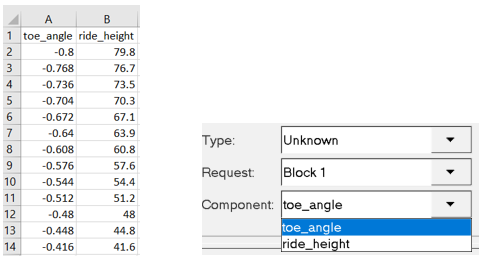

- Select the u, x, y, or z radio buttons (depending on your selection in the previous step) and choose File, Math or Values as the data source for the curve from the corresponding drop-down menu.
Define the data source.
If File is chosen:If Math is chosen, the curve calculator is displayed, allowing you to define the vector mathematically. Below are two sample expressions:
Expression Description crv_2d_math.x = 0:10:1 X vector expression to generate a series of numbers from 0 to 5 at regular intervals of 0.1. crv_2d_math.y = cos(crv_2d_math.x) Y vector expression to apply a cosine function on the X vector of the curve. If Values is chosen, enter the u, x, y, and z data values for each point. You can cut, copy, paste and insert data point values using the buttons to the right of the table.Note: The available data points will depend on your curve type selection in the first-drop-down menu.Tip: Click
to
view the Data Values dialog containing all data
points.For more information on the Type, Request, and Component options, see Building Plots with XY Data Files in the HyperGraph on-line help.

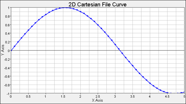

- Click Show Curve to display a curve preview dialog.

- Click Show Curve to display the curve Preview dialog.
- Select Symbols to place symbols on a curve to indicate data points.
