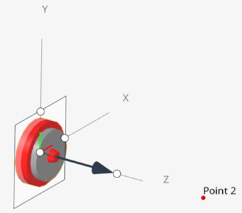

- By defining a joint between two bodies (referred as I Body and J Body), the
constraint between the bodies is imposed using two markers or coordinate
systems (I Marker and J Marker) belonging to each body. By orientating a
joint, these markers are oriented in certain directions along or about which
the joint has degrees of freedom (usually Z axis of the markers).
Figure 1. Z Axes of the revolute joint oriented along a point
