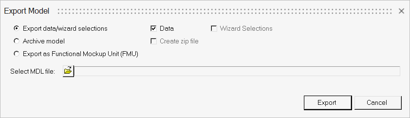

Select the relevant type of export from the Export Model
dialog:
- To export the data or wizard selection (or both), locate and specify a
relevant MDL file to export using the Select MDL
file browser
. Figure 1.
MotionView will verify for valid choices and may automatically disable or select relevant options.Export data/wizard selections To export data and/or wizard selections information. Data Select the check box to export the data in the model. Wizard Selections Select the check box to export wizard selection information. - To archive the model:
- Select Archive model.
- To save the archive into a zip format, activate the Create zip file check box.
- Use the Select Directory file browser to
provide a directory where the model needs to be archived.
Without the Create zip file option activated, a folder will be created under the selected directory bearing a name mdlfilename_Archive, where mdlfilename is the name of the model file. The folder would contain the model file and other associated referenced files.
With the Create zip file option activated, a zip file will be created under the selected directory with same naming convention described above. The zip file would contain the model file and other associated referenced files.
