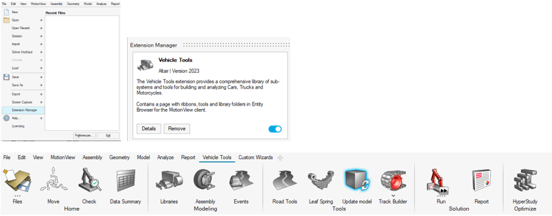

Update Model Tool
Update Model is a tool available in the Vehicle Tools extension used to update vehicle models created in older MotionView versions.

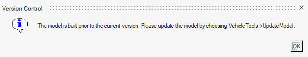

For vehicle models without the Altair Driver, no message is provided, and the model can be simulated just as it is. However, it is still recommended to update the model to upgrade and adapt some of the features and its dependencies to new vehicle level requirements. In case the model is loaded in a recent version and saved to disk without executing the Update Model tool, the version control message will not be prompted to update again.

Update Model works based on the model's version number and content. If an older model is loaded and saved, the *BeginMDL() statement at the beginning of the MDL will now contain new version number information. Since the Update Model tool is based on the version number, it will not update models with the newest version number.
