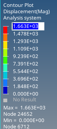

Graphical Editing Mode

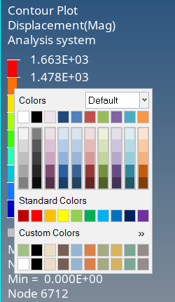

The values and colors of the legend can be edited in-place directly on the legend itself. Simply left-click on the value to enter the edit mode and type in the desired value.
Editing of values is not supported for category based legends.
