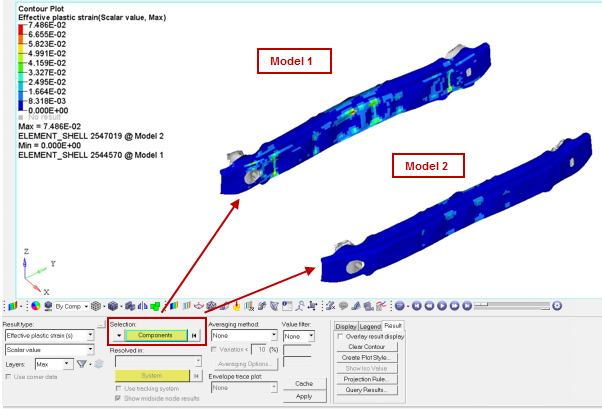

Multi-model Result Plotting
HyperView allows for plotting (contour, iso, vector, or tensor) across multiple overlaid models.
If you are attempting to plot a certain result-type (or a particular layer or
component of a result type) and it is not available in one of the overlaid models, a message
will be displayed to that effect (for example, Message: Data type Stress does not exist in
Model 2) and no plotting will occur on the non-current models.

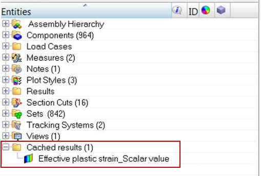

- Caching policy
When you create a results cache from a panel or browser, it creates a cache for every model that participated in the result plots and it will be listed in the browser for each model separately. HyperView will internally maintain a record of related caching entities. When the saved cache is deleted from the panel or browser, it will also be cleared from the browser list for each model.
Figure 2. Results Browser with Cached Results displayed
- If an overlaid model does not participate in contour plot, then a cache entity will not be created for that model.
- If contour is plotted and cached across several models and one or some of the models are later deleted, the cache entity will remain on the models which were not deleted.

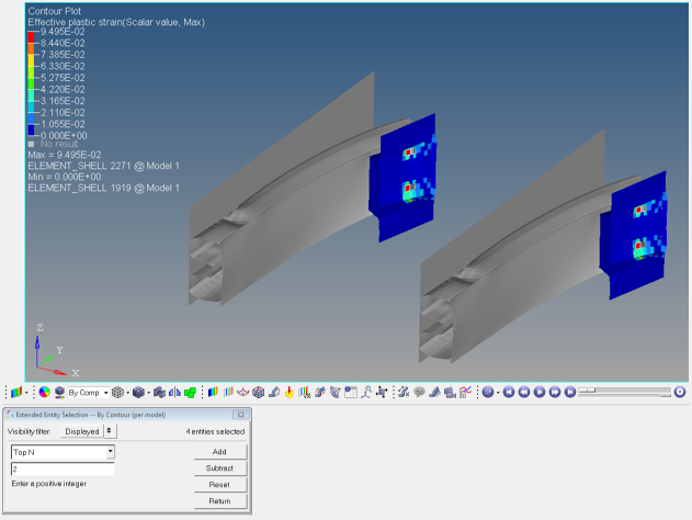

- Extended selection by contour option
For overlaid models, this selection method will work on a per model basis. For example, if you want to select elements using the Extended Entity Selection -- By Contour method and you search for Top N with N=2, HyperView will select four entities (two entities for each model).
