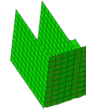

The nodes that are disconnected display.

Figure 1. Find Disconnected Nodes Automatically (Apply)
Figure 2. Create Elements Between Disconnected Nodes
