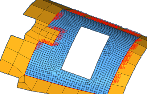

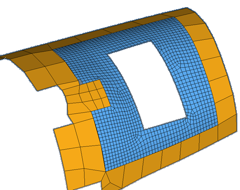

Figure 1. Coarse (GFEM) and Fine (DFEM) Mesh
Figure 2. RBE3 Connection only on the Two Free Edges of the GFEM and DFEM Element Sets
