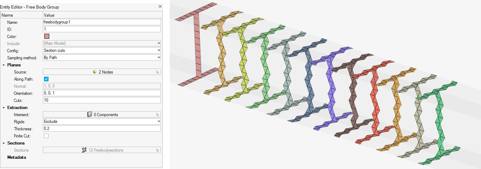

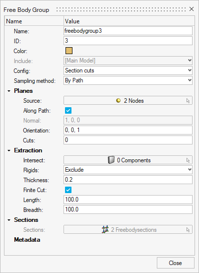

Generate Free Body Sections Along a Node Path
From the Post ribbon, select the Create Free
Body Group tool.
Figure 7.
- In the Free Body Group dialog, verify Section cuts is selected for Config.
- For Sampling method, select By Path.
For Source, select at least two nodes to define a polyline of straight
segments.
Note: A Free Body Section will be created at each location selected for Source.
- Sample multiple sections along each segment.
- Optional: For Cuts, enter a value greater than 0 to evenly distribute intermediate planes between each node.
Select Normal.
The Along path option controls the normal of each Free Body Section created.
- If the option is cleared, then all Free Body Sections will share the same normal vector defined in Normal, see Figure 8.
- If the option is selected, then the following rules apply:
- Planes distributed between two consecutive nodes have their normal aligned with the direction formed by the two given nodes in ordered way.
- If a node is shared between two segments along a path, then the local normal on that node is driven by the next segment.
Define the Orientation.
The vector defines the system of each plane using the following rule:
- Z-axis = Normal
- Y-axis = Normal ^ Orientation
- X-axis = y-axis ^ z-axis
- Optional:
Select Finite cut to create Free Body Sections of finite
cut type using the Length and Breadth options.
- Length: section dimension along local x direction centered on the base point.
- Breadth: section dimension along local y direction centered on the base point.

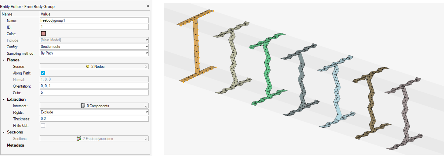

Update Free Body Sections Along a Node Path
- A bulk update of all children entities is done without deletion, whenever possible.
- If the number of Cuts or the Source nodes are changed, then previous Free Body Sections are deleted and new entities are generated.

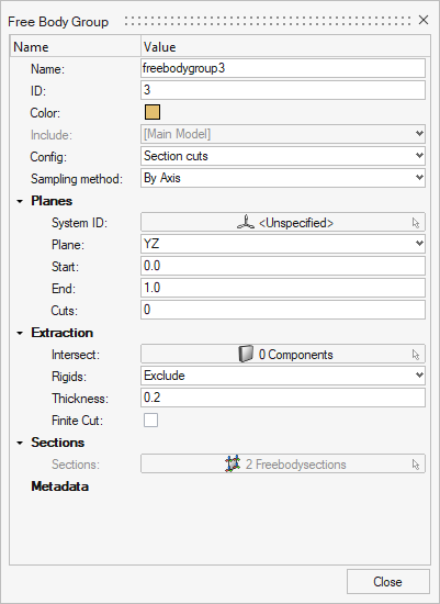

Generate Free Body Sections Using a System
Body Group tool.
Figure 11.
- For Sampling method, select By Axis.
- Optional:
Select a System.
Note: By default, the global system of HyperMesh is used.
Define a Plane.
The selection of the plane will feed Normal and Orientation datanames of all Free Body Sections using the following rules:
- XY: Normal = System z-axis and Orientation= System x-axis
- YZ: Normal = System x-axis and Orientation= System y-axis
- ZX: Normal = System y-axis and Orientation= System z-axis
- Optional:
